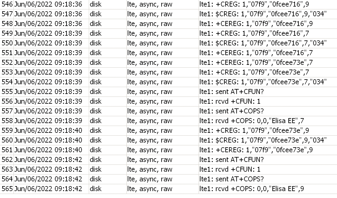

Hey so the connection dropping is back. Now a bit different i replaced the sxt-lte with LHGG and it usually works fine but randomly at some point there is not connection to the internet. ping to google dns failes but to the router itself is okay. Once i use winbox to connect to the router then immediately the ping to google dns 8.8.8.8 starts working again. How can i start to analyse this problem to find out what is the problem?
Another thing that happens is that the uptime of LHGG after each incident goes back to 0 like it did a reboot. But in the log it does not say that it did a reboot. The session uptime on lte1 interface also goes to 0.
Upgraded the lte modem firmware lets see if that fixes anything.
/interface lte firmware-upgrade lte1
installed: R11e-LTE6_V033
latest: R11e-LTE6_V033
Nope same thing again. Added lte logging, no info there as well.
