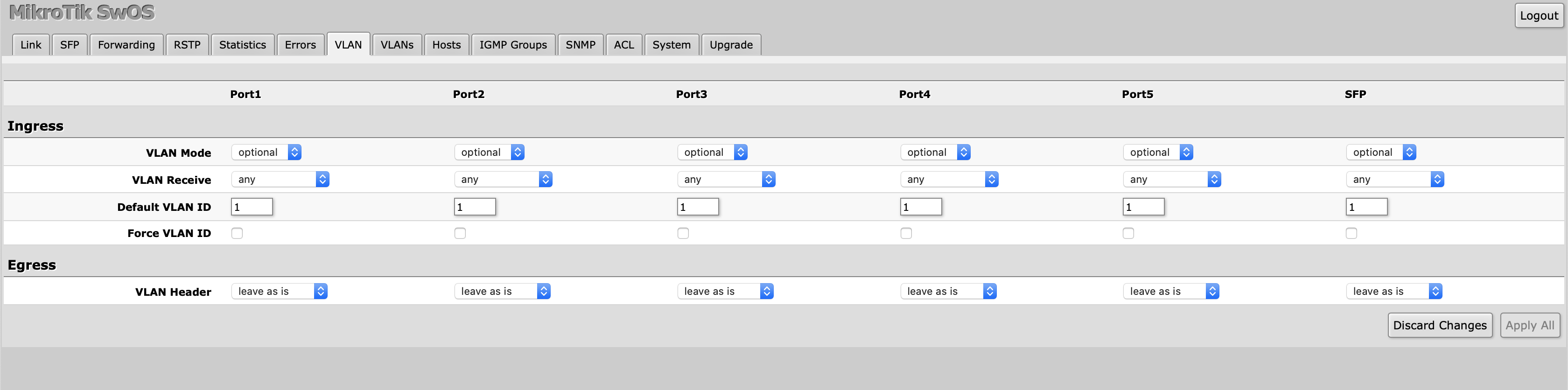

The setup is very simple and i have attached every single devices configuration export as well (except switch). Switches have been assigned static ip addresses and on 192.168.88.5 switch i have ticked the box that says Long PoE in cable.

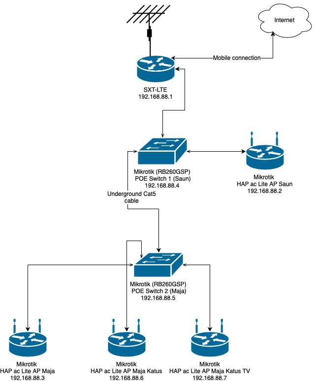

Also i have attached the network topology:
Every AC lite box runs 2.4GHz and 5GHz on different channels to make sure they don’t overlap. There is only one exception for that and that is 192.168.88.2 and 192.168.88.3 have 2.4Ghz wifi netowrk set on channel 1 because they are both in different buildings and distance between those buildings is about 30-40 meters. Underground Cat5 cable runs between those buildings as well.

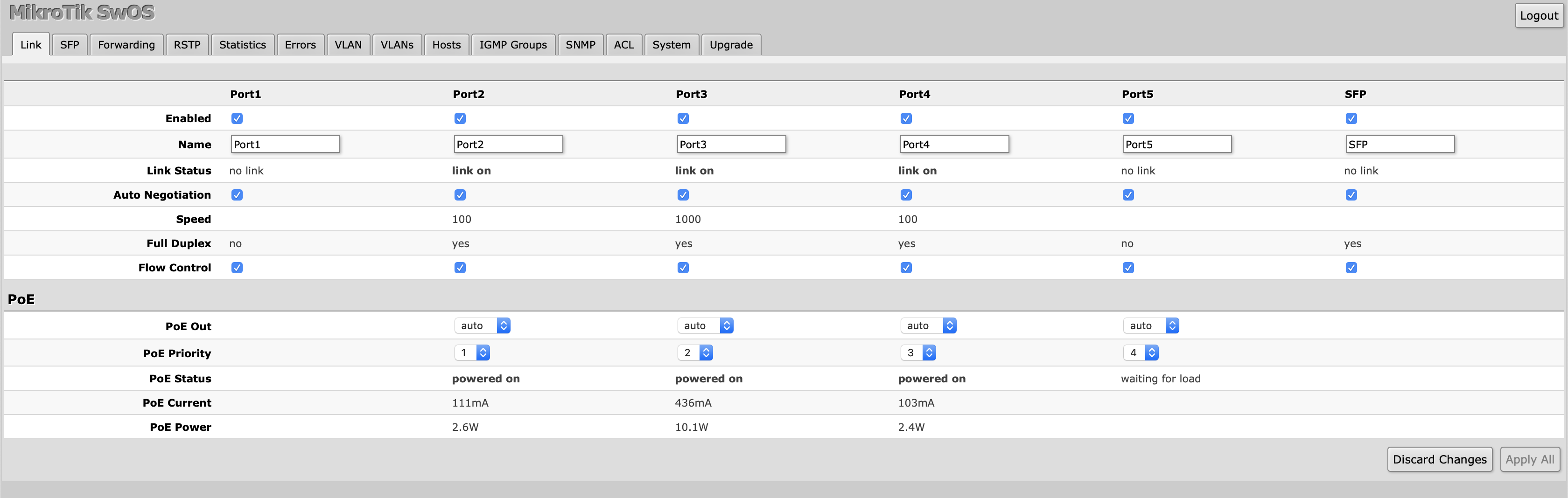

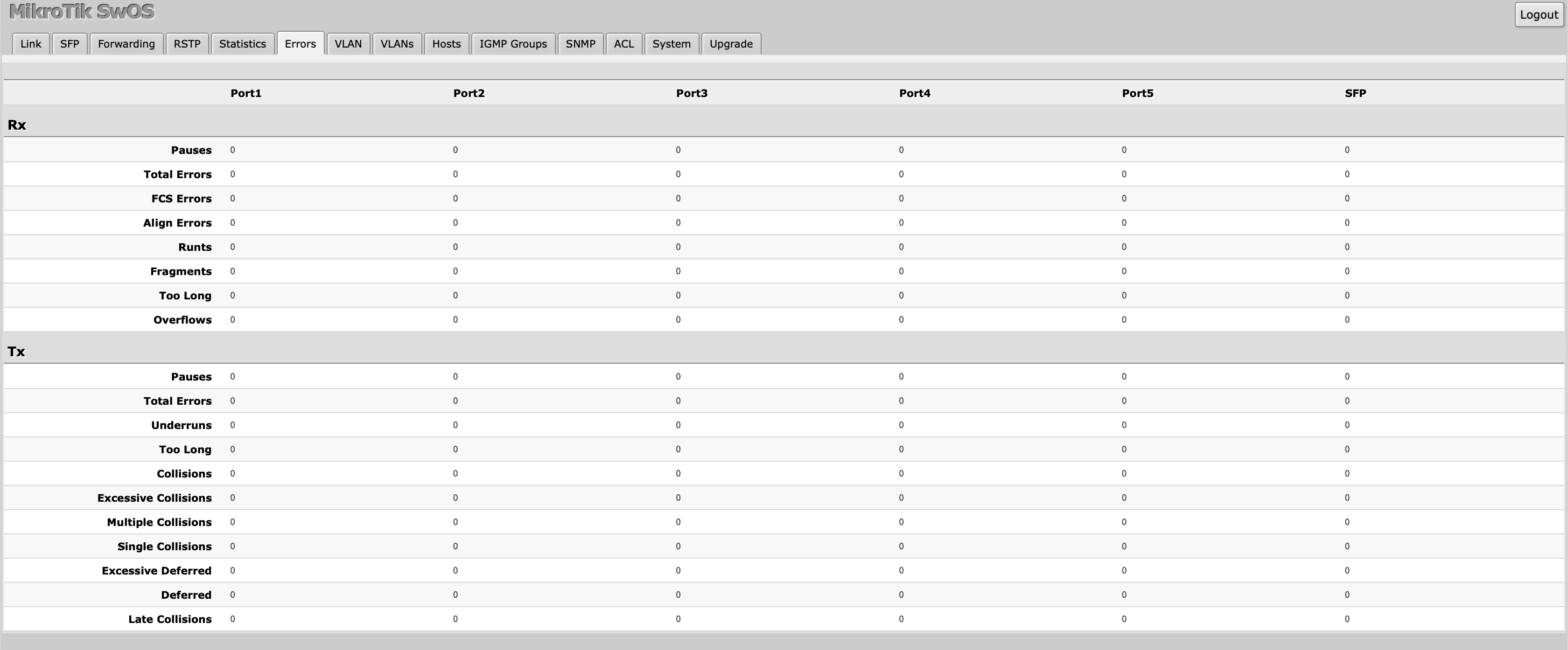

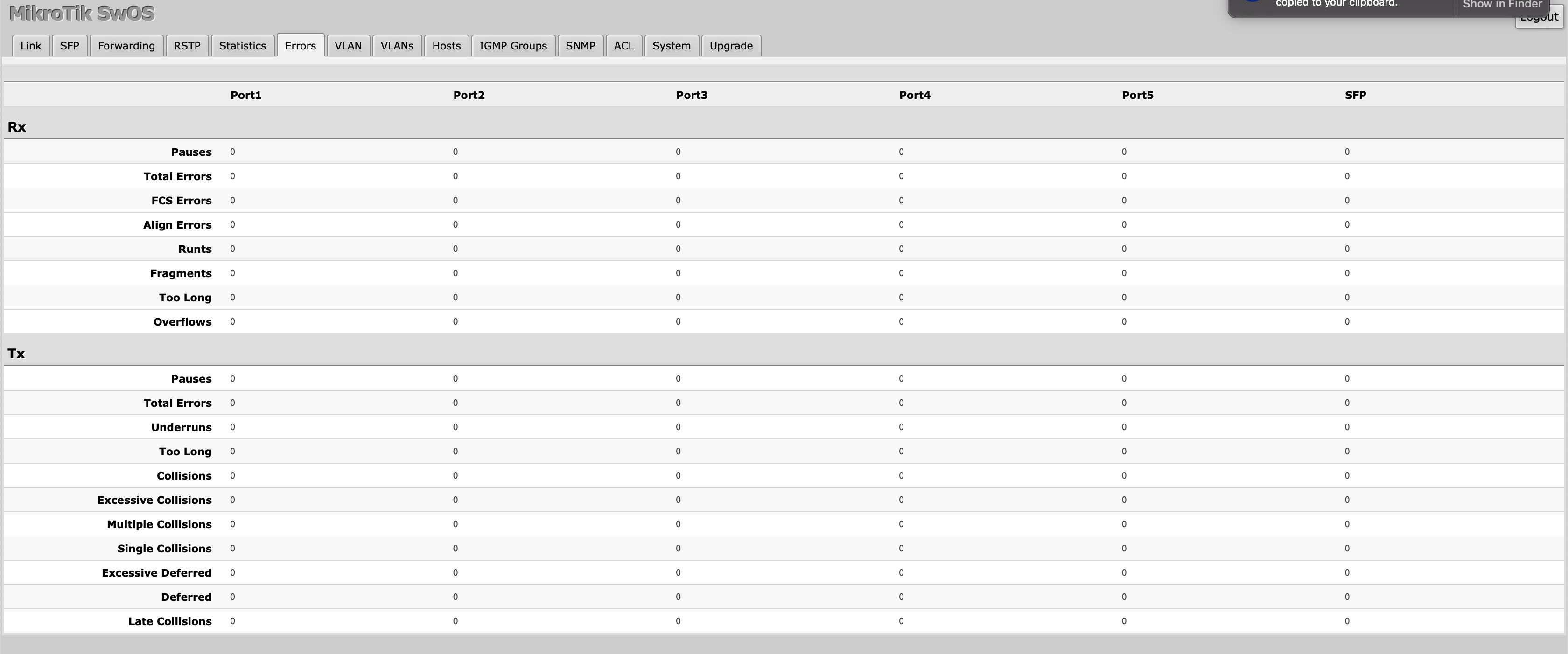

BTW try login into your switches and check that you don’t have tx/rx errors on ports.
How long is the cable between sw1 and sw2?
Will try to ping them on friday when i get back there.
One of the first things i checked was TX/RX errors on switches, there are none.
Cable is around 40-45 meters long.
The same problem happens if connected to 192.168.88.2 (AP Saun) and from there the distance to the switch is about 30 cm and from switch (192.168.88.4) to SXT-LTE (192.168.88.1) the distance is 4 meters.
The SXT-LTE is positioned behind the house (outside) with a perfect line of site to the cellular tower. There is nothing blocking the signal from SXT-LTE to the cellular tower you can see the tower and it is about 3km away

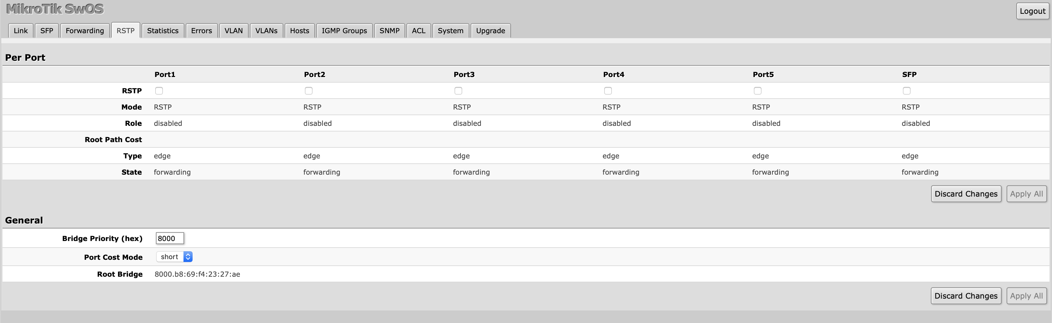

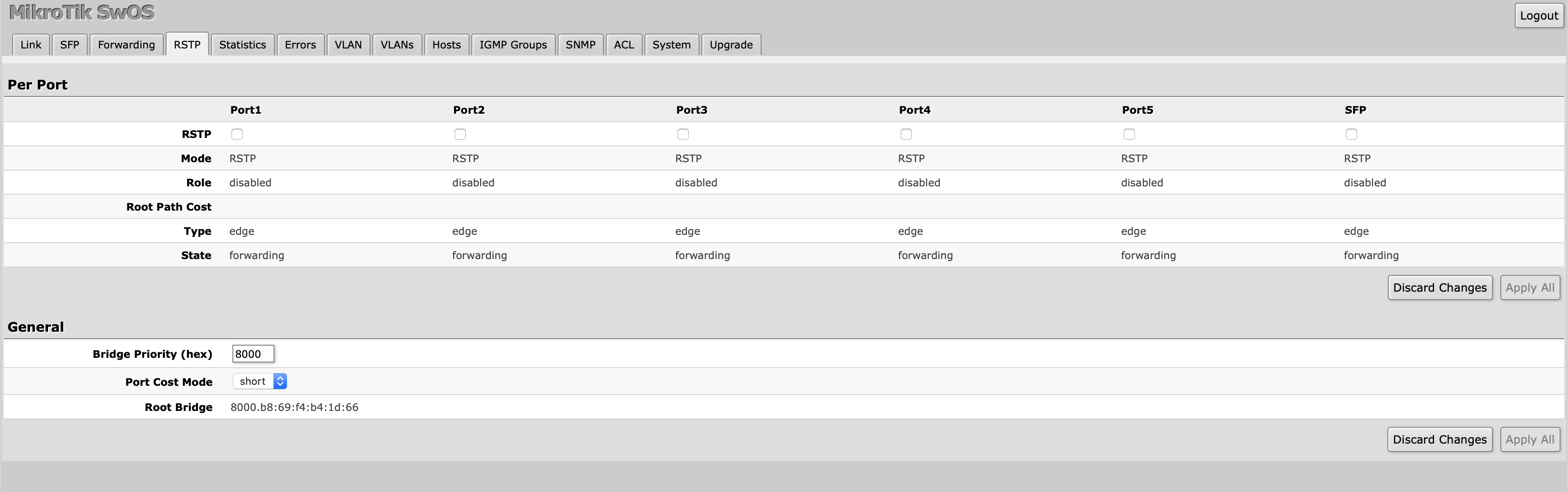

  1. Disable RSTP on all of you devices. Including switches.
set  [ find name=bridge1 ] protocol-mode=none
On switches>
Go to the RSTPtab and switch off RSTP tick on all ports.

Why should i disable RSTP ? I don’t really understand that.
First of all it’s useless in your network topology, the second one that it can be a source of your current problem…i’m just proposing an ideas what can help you…

I did not really understand what RSTP was.. that’s why i asked about it..
RSTP - Rapid Spanning Tree Protcol, it help prevent bridge loops in networks.
https://en.wikipedia.org/wiki/Spanning_Tree_Protocol

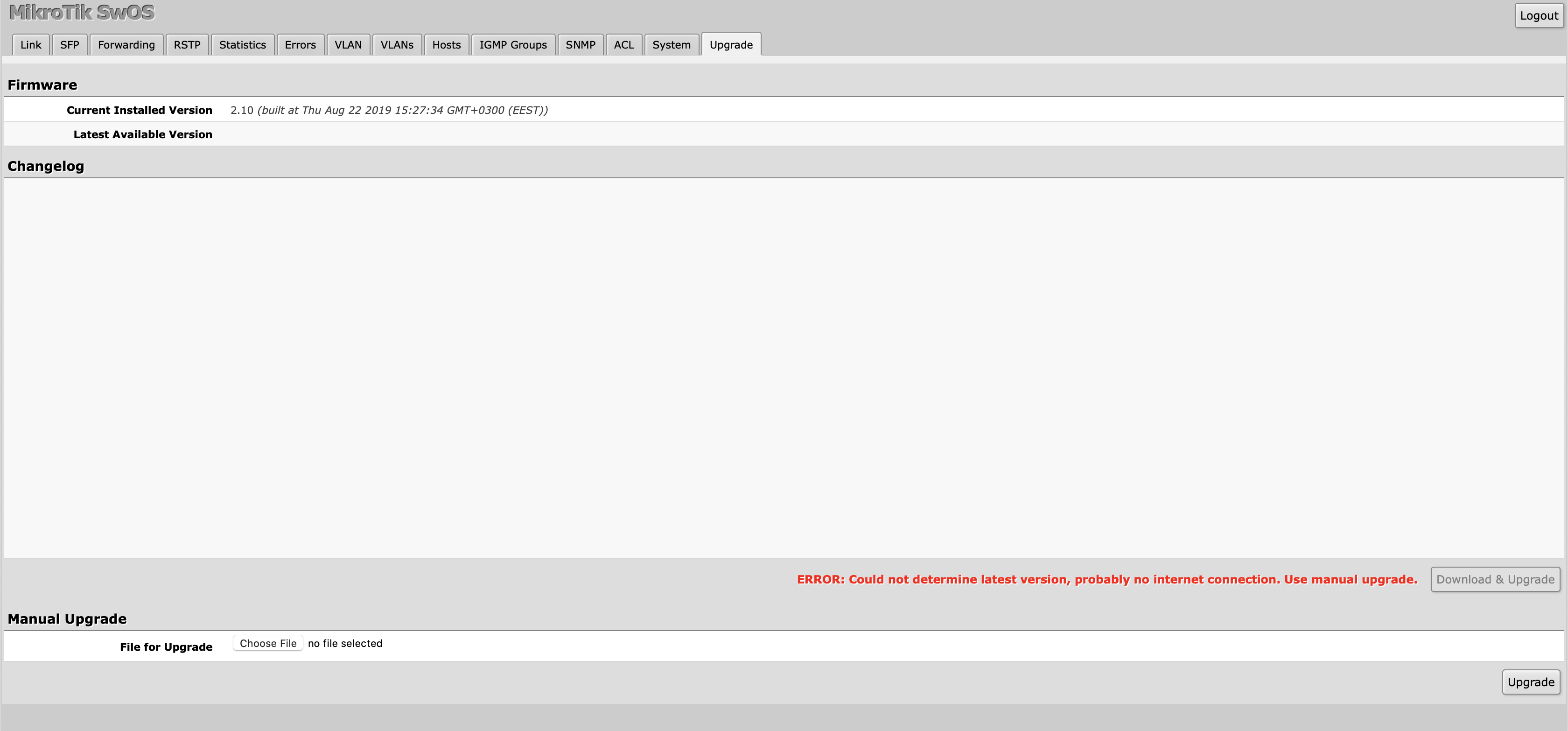

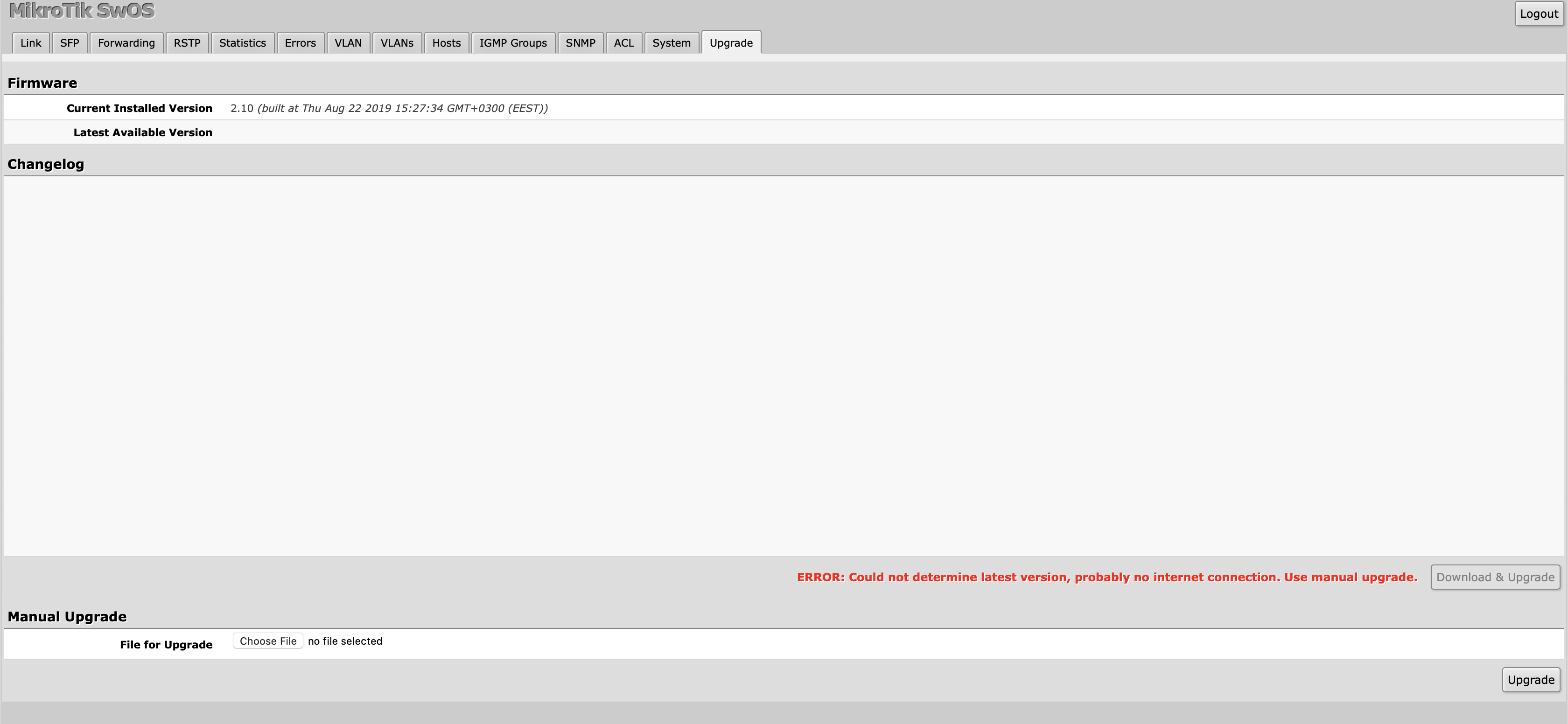

After the changes switches started to say this error on the upgrade page:
ERROR: Could not determine latest version, probably no internet connection. Use manual upgrade.

The problem with the switches still does presist: ERROR: Could not determine latest version, probably no internet connection. Use manual upgrade.

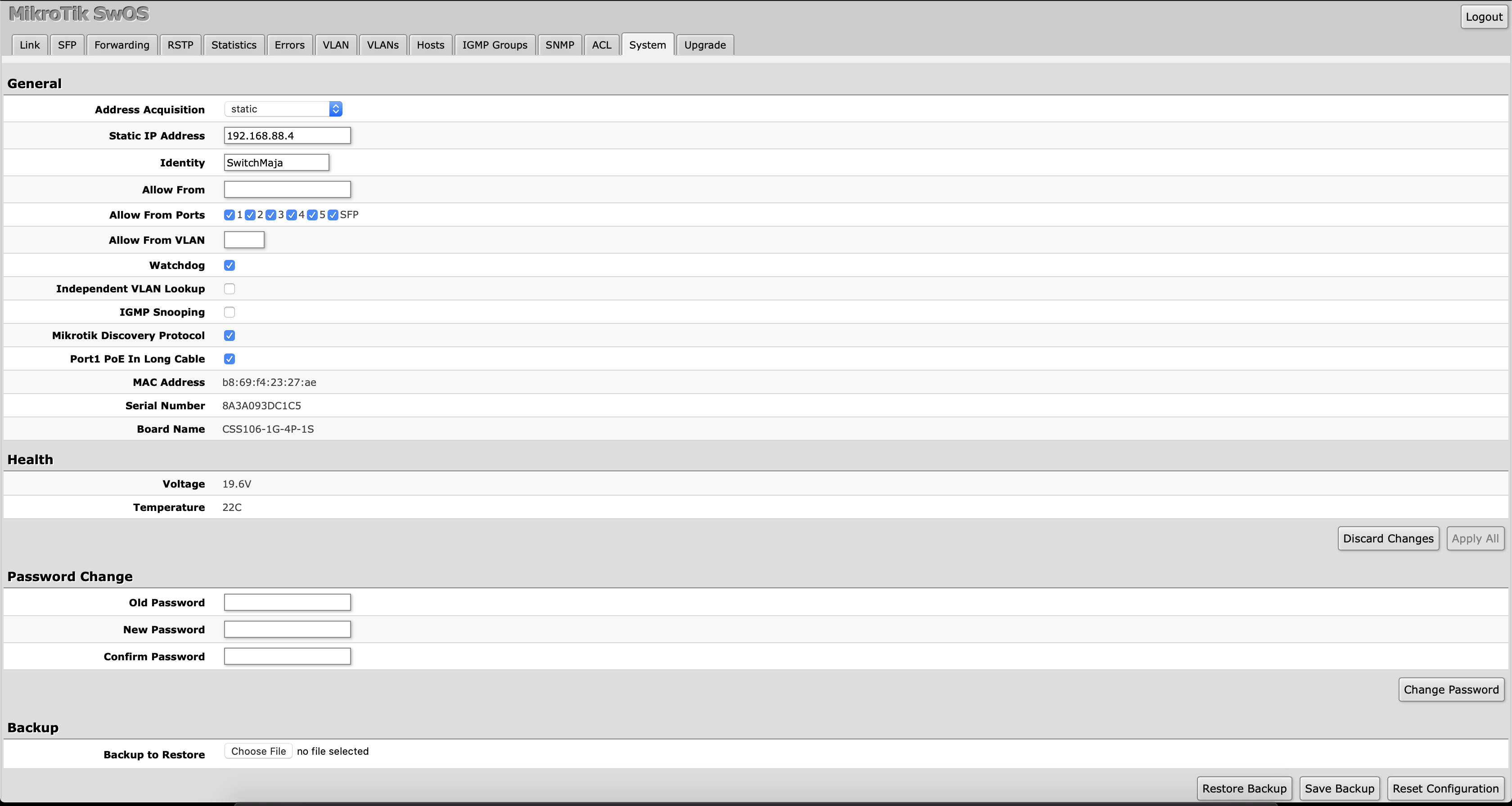

SwitchMaja (192.168.88.4) config:
SwitchSaun (192.168.88.5) config:
Don’t be concerned about this problem now…It’s not related to your current issue at all…

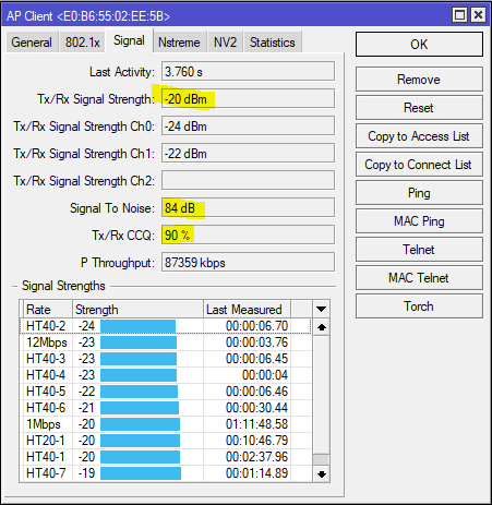

Find you iPad MAC address, than log in your AP’s and look at this parameter > “Wireless>Registration>TX/RX Signal strenght” . If signal strenght for ipad <=-80 dBm (-120..-80 very poor signal, wifi will not work with such parameters). Second one what you should look it’s a signal quality CCQ and SNR
Here is good explanation of SNR,CCQ, … signals.
http://forum.mikrotik.com/t/noise-floor/66971/1
okay but i would like to get to the bottom of that problem as well.. any ideas on that?
In my opinion, Mikrotik switch can’t obtain upgrade software info because you defined a static IP on it. As you can see you defined only static IP but there are no fileds for mask, gateway and dns and hence device don’t know how to reach update server.
P.S
Personally i have same behavior on this device, but it’s not bothering me and a’m doing upgrade manually.
