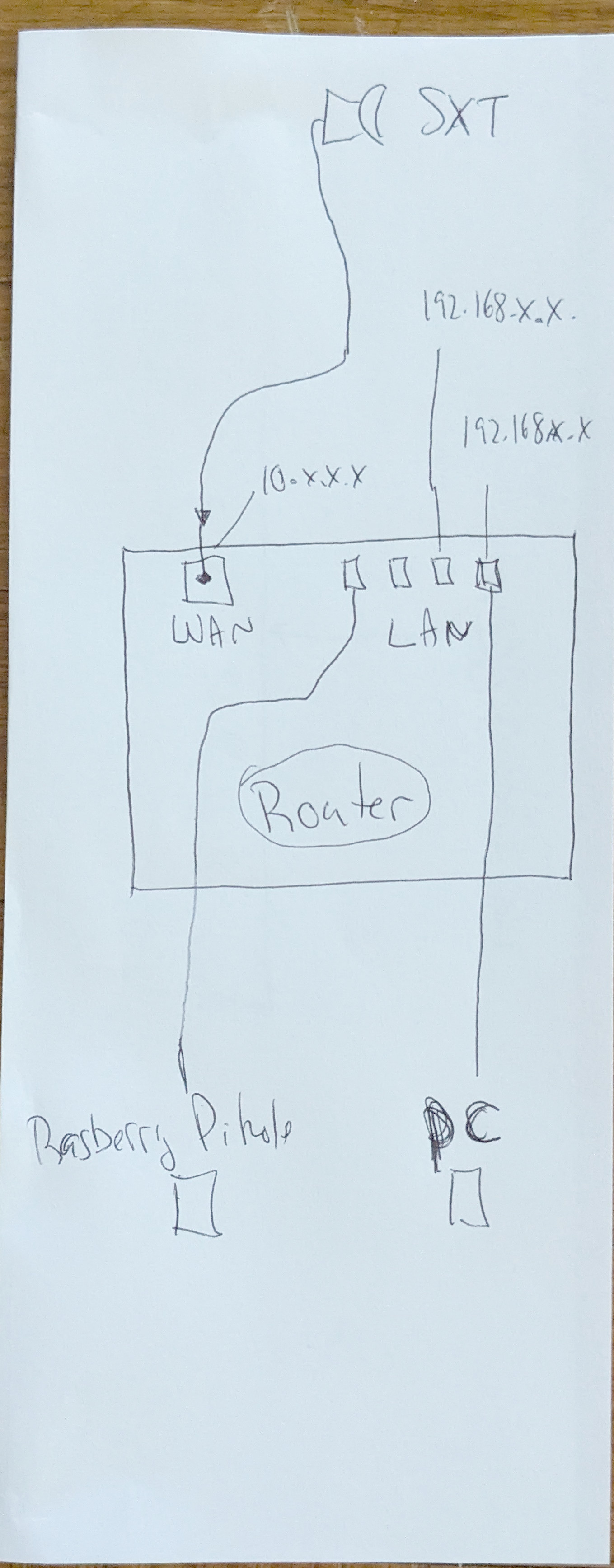

See attached image. The 10.x.x.x mikrotik range cannot be changed and I prefer not to change the router ip assignet as I use it to go back and forth between two sources of internet connectivity.

Good, now your setup is more clear.
The Sxt is basically setup as a switch/bridge, right?
The device “router” is where the “magic” should happen if you cannot or don’t want to change configuration on the Sxt.
So, which make/model is the “router”?
Which device is running the DHCP server on the LAN (192.168.x.x) and which DNS address is provided?

From what I understand, in a situation like yours it would be possible (if we are freed of the limitation/costraints) and simpler to use the Sxt as a router and the Asus as a switch (or replace it with a switch) still it should work also “as is” with an appropriate configuration of the Asus and of the pihole.
wouldn’t the problem be that you have two different networks using one router.
I haven’t yet tried to see if pluging the 192.x.x.x. network (which has the pihole) into the router TOGETHER WITH the 10.x.x.x sxt plugged into the router simultaneously knowing that they are seperate asisgnments/IPs ranges. . . and therefore will not communicate - isn’t that so?
Re: current pihole settings - I have to input into the network manager that my dns is the pihole device otherwise it won’t ad block. And if I do, then revert the network manager back to say 1.1.1.1 I still get working connections just with the advertisments. So network manager seems to be doing it’s job.
Then I am completely missing what the problem is.
You have a 10.x.x.x network which is WAN and a 192.168.x.x which is LAN connected to a router, which should allow LAN to access WAN and internet (i.e. route between the two) It seems normal to me. :confused:
