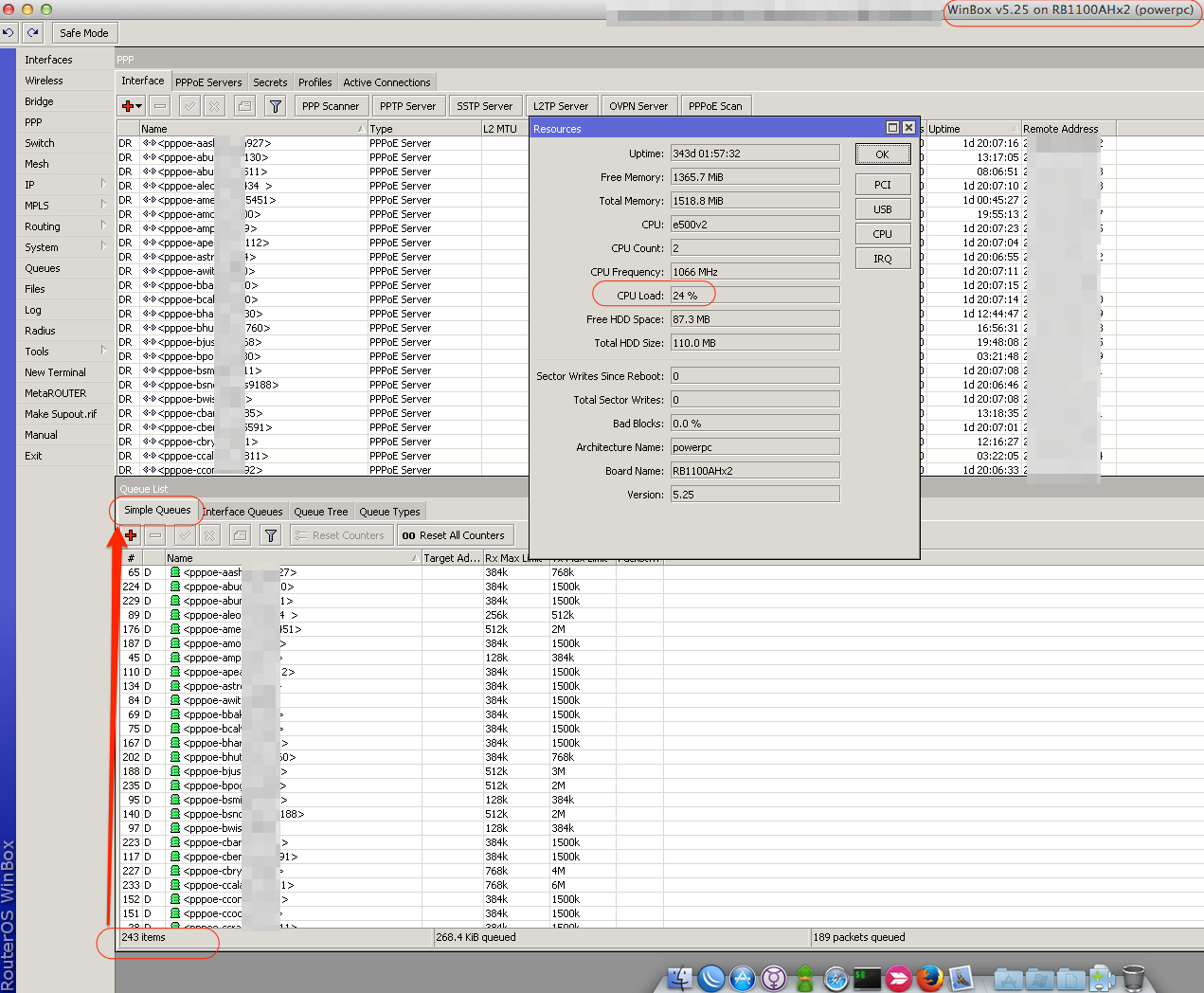

The router in the picture below has been servicing over 200 customers using simple queues for about a year without even rebooting.

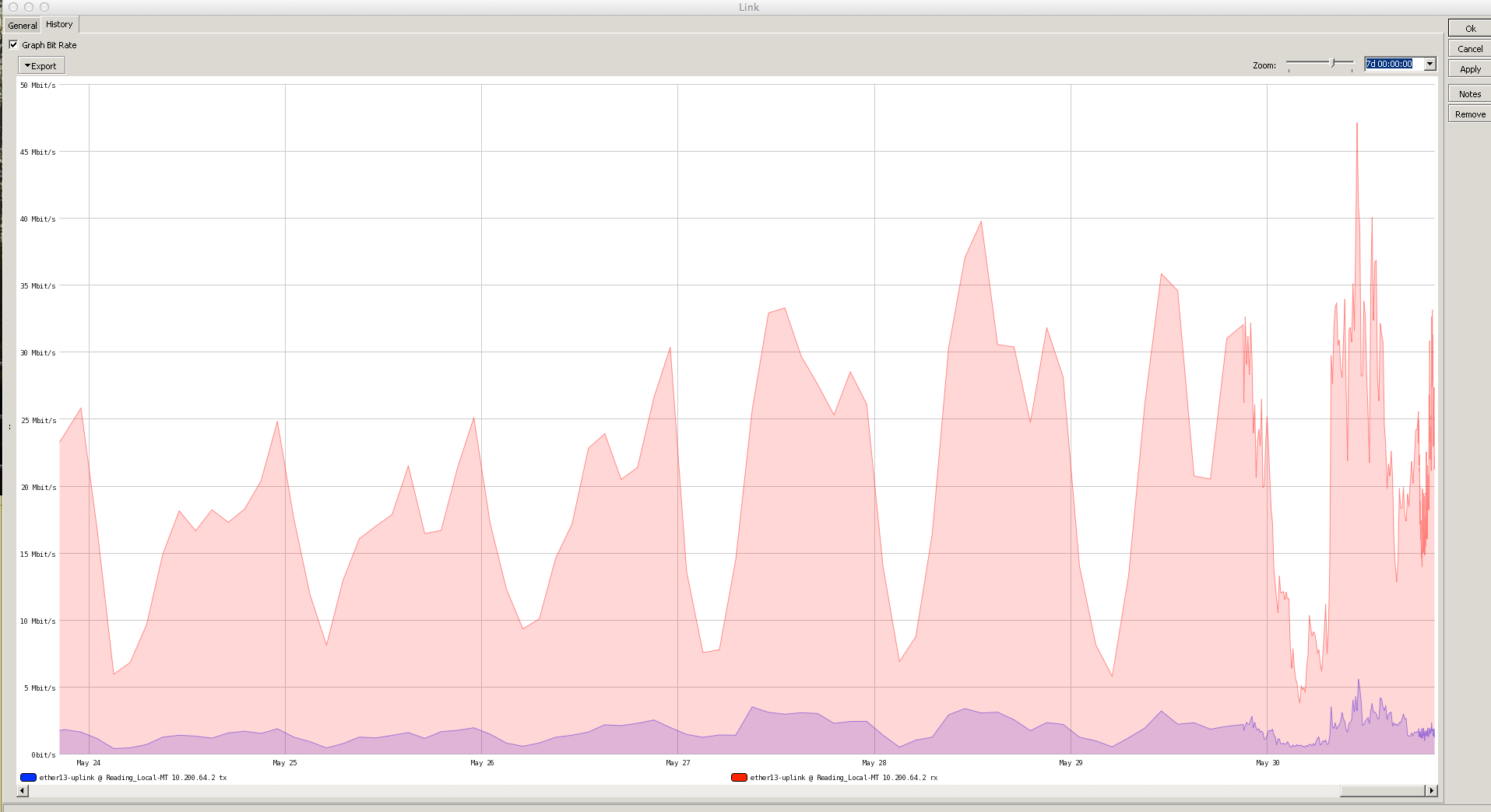

The router I pictured was a local router so that router only passes a bit over 40Mbps (7 day chart attached). I have an RB1100AHx2 right next to it that does distribution traffic peaking up to 300Mbps but that router isn’t doing PPPoE or Simple Queues. It is however using the Queue Tree for QoS for backhaul traffic.

I don’t have much experience with the CCR but I expect that it will work very well for you. The PPC chip is much better then the MIPSBE so don’t underestimate the 1100AHx2 based upon seeing a performance wall with the 2011. Even if the 1100 wasn’t dual core and wasn’t much faster per core just the chipset change would render better performance. I am guessing that you are pushing the 2011 about as far as I trust them with 40Mbps along with queuing etc. The 2011 is more of an endpoint firewall then a infrastructure plus qos & PPPoE concentration. I would recommend using the 2011 to build small sites but always plan on replacing them once growth warrants it.
