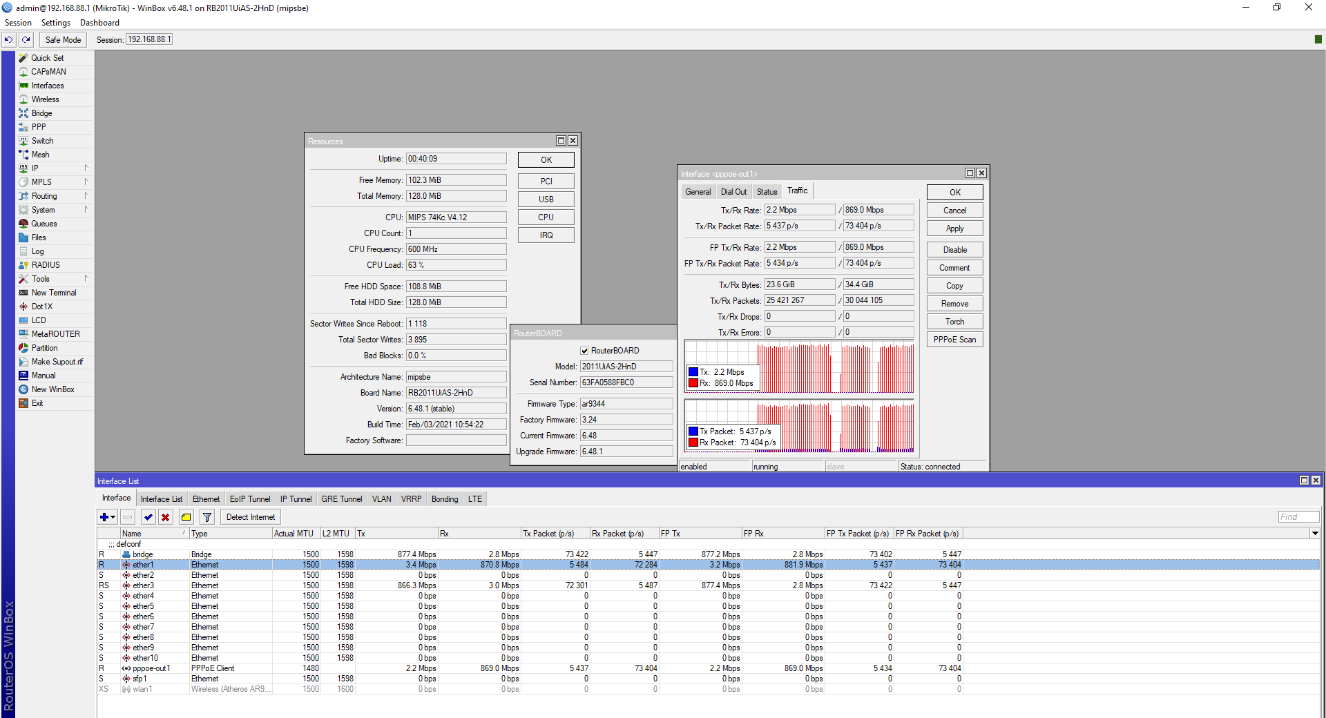

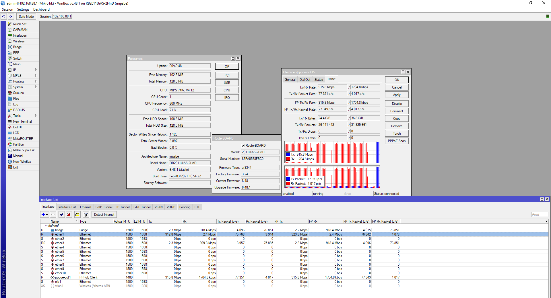

I just took my old rb2011uias from storage, reset it, added pppoe client.
Attached is the result running simple iperf3, could be unrealistic test case, but I think this is ‘best case’ scenario?
Quite possibly it’s an unrealistic scenario. If firewall did not have any rule, then I guess router doesn’t perform connection tracking (I may be wrong) which is single most expensive task performed by firewall/router. Router had 60%-70% CPU load during the test … and if indeed it only performed PPPoE encapsulation/decapsulation, then it’s a sign of just how much PPPoE really is a burden for this device. It would be interesting if you performed similar test, but without PPPoE in the mix (i.e. straight routing case), the difference in CPU load would indicate the amount of work needed simply for PPPoE.

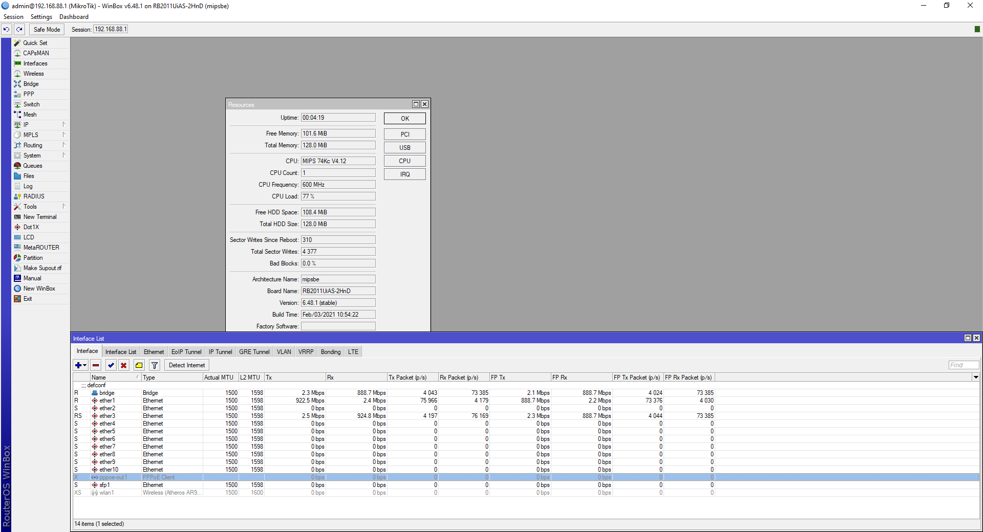

I reran the test by replacing pppoe with normal routing but keeping nat.
There is no significant difference in both CPU usage and throughput.
The configuration was for pppoe. For non pppoe, I just disabled pppoe-out1 interface and added static ip and static default route.
rb2011-pppoe.rsc (3.71 KB)
