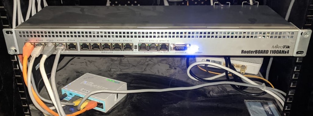

Naa. it does not work. Just replaced with a new one. Lets hope that it works. There is nothing in the log. So cannot investigate at all. Please check the attached picture; it comes into this position, all ethernet lights turn off, i hear the relay CLICK sound and its gone, only blue led is on; I have to plug the power out and back in for it to work. No restart no nothing, POWER CYCLE to work. This has become a huge issue for me. Hex was working fine, unfortunately hex’s license level is low.
