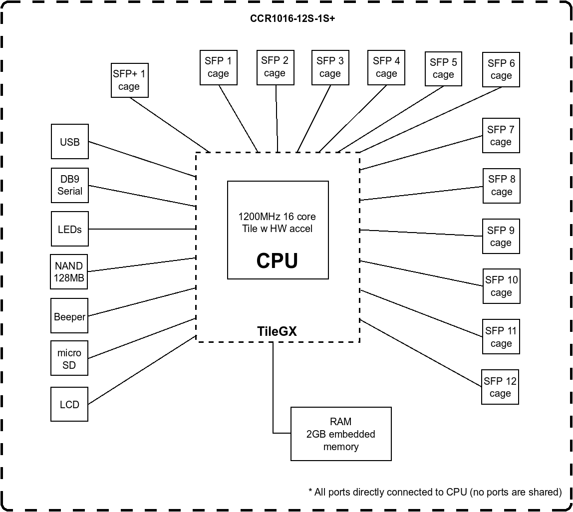

The CCR routers have MUCH higher throughput than the RB1100AHx4. The CCR’s are intended for core routing, with multiple networks attached. The RB1100AHx4 is geared more towards a larger business network. You can check out the block diagrams for each to see the design differences. On the CCR’s, each port is directly connected to the CPU, providing a full wire-speed throughput. The RB1100AHx4 uses switch chips, each connected with a 2.5Gbps link.

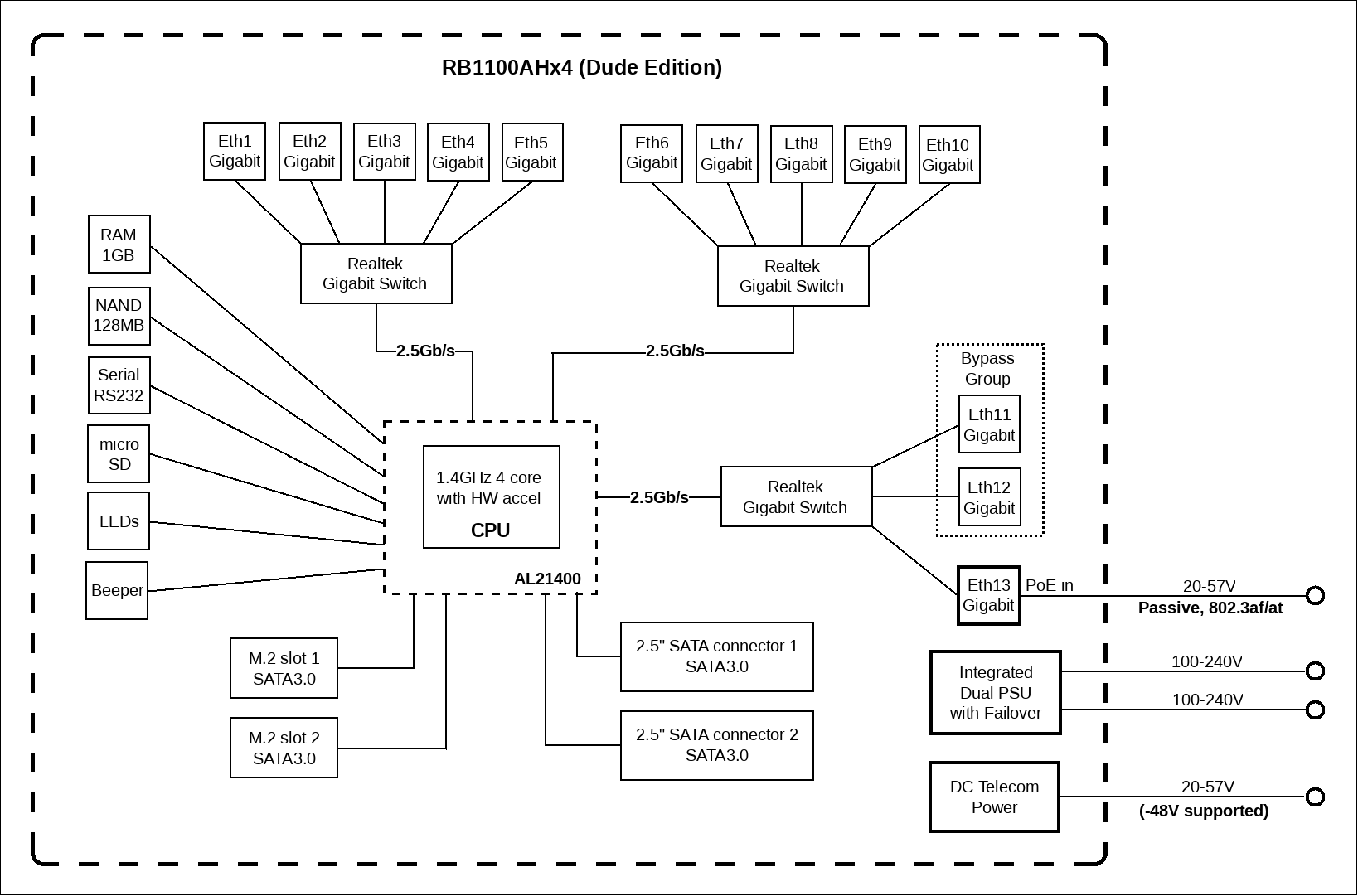

Not only CPU is different, but how the ports are connected to it. Consider these block diagrams. CCR has all ports directly connected to the CPU. The RB1100 has switch chips in between. The connection between switch chip and the CPU is less than the sum of all port speeds.

This device has three switch chips ether1-ether5, ether6-ether10 and ether11-ether13 and on each of them total throughput is maximum 2.5Gbps
Each separate port supports maximum 1Gbps.

Probably one could increase the number of ports, interconnection and streams to force the router to it’s maximum capability, but for the two 1Gbps WANs that I want to use seems fine for me. I am now sure the 7.5Gbps is achievable per the specs sheet/drawing.
