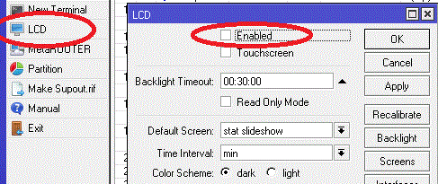

maybe a nonsense, but try to disable the LCD on rb2011 ..
how can I do ?
the packages loaded are:
adv-tools
system
security
routing
ipv6
not a package, look at the menu item LCD..
I try.
I will let you know,.
The very first test shows interesting results… stay tuned I will post them later
The problem is definitely the LCD. If I disable them I get very fast speed
Funny, isn’t it? Dumb lcd throws down the router’s performance. Mabe shared irq or something like that. Report it to support and hope they will fix it.
as i told.. a nonsense ..but it works :smiley:
