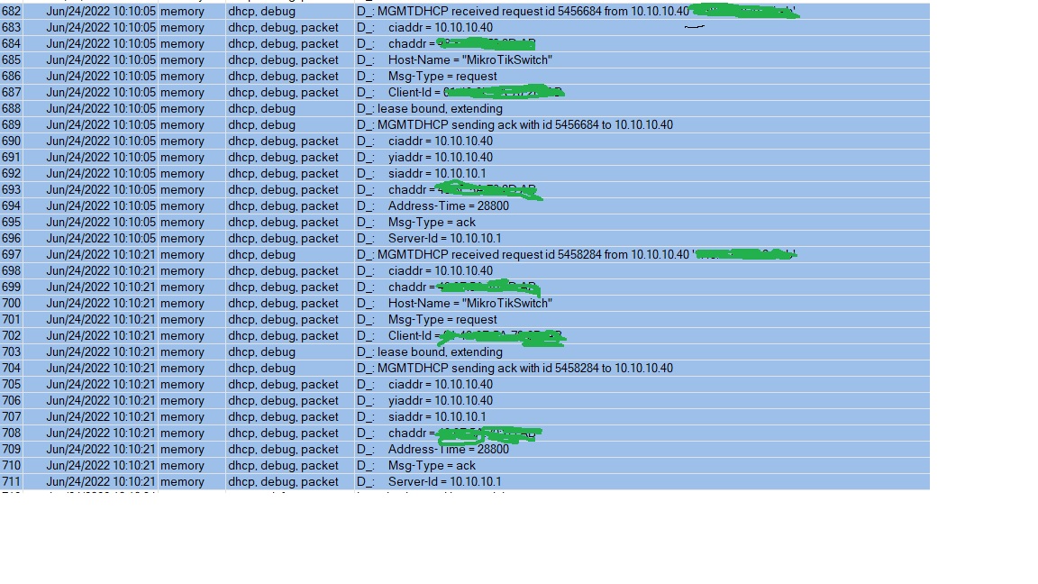

attached is the debug log from the upstream dhcp server.(rb450gx4)..notice every 15 seconds..there is activity..
And nothing else about that device or ethernet port through which it connects?
