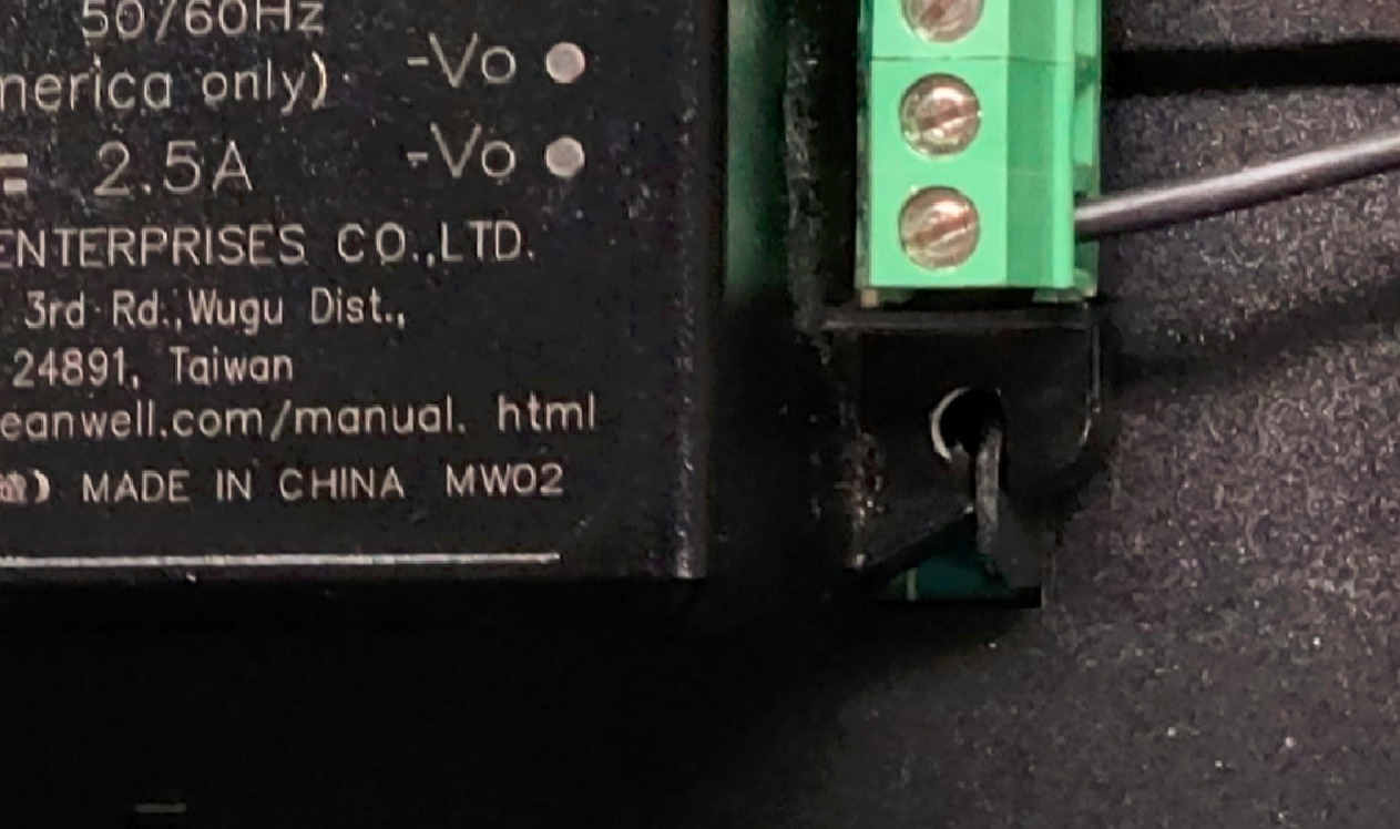

I put in a nice commercial Mean Well IRM-60-24ST encapsulated 100-277vAC 60W/24vDC power supply with a good filtered C13/C14 AC input (no fuse or switch).
It’s internal, better/cleaner power, more watts, soft start, grounded, but requires some work.
The reason they don’t do it is because then the router box would have to pass different certifications and would cost more. So, the external power brick is cheap and easy.
The mod is about $30 in parts (plus little stuff). Soldering required. I guess you could use the existing power brick DC cord as a pigtail and just do it that way (no soldering).
The router only uses about 10W idle. More watts when doing work, so the factory 28W power supply is more than enough unless you use the power output and would need extra watts.
I picked this power supply because it was all voltage input, 24V/60W, and the right size to mount in the existing space. Even de-rated for extreme heat it would provide more than enough power.
I cut a notch at the side of each of the four mounting holes on the power supply so it would just slide onto the four existing mounting tabs. It is rather secure but I used strong double sided tape on the bottom of the internal power supply to make sure. It’s not going anywhere. I did use a good soldering iron to connect the wires to the board. You could cut off the DC plug from the adapter and feed it through the cooling holes and just plug it into the existing socket. A little weird, but easy to do. I just connected the AC ground to a good internal screw (like the external ground would have).
I would guess the “factory” option would have used a metal hold down strap over the power supply and be secured by two screws in the existing holes. The sticky tape was easier for me.

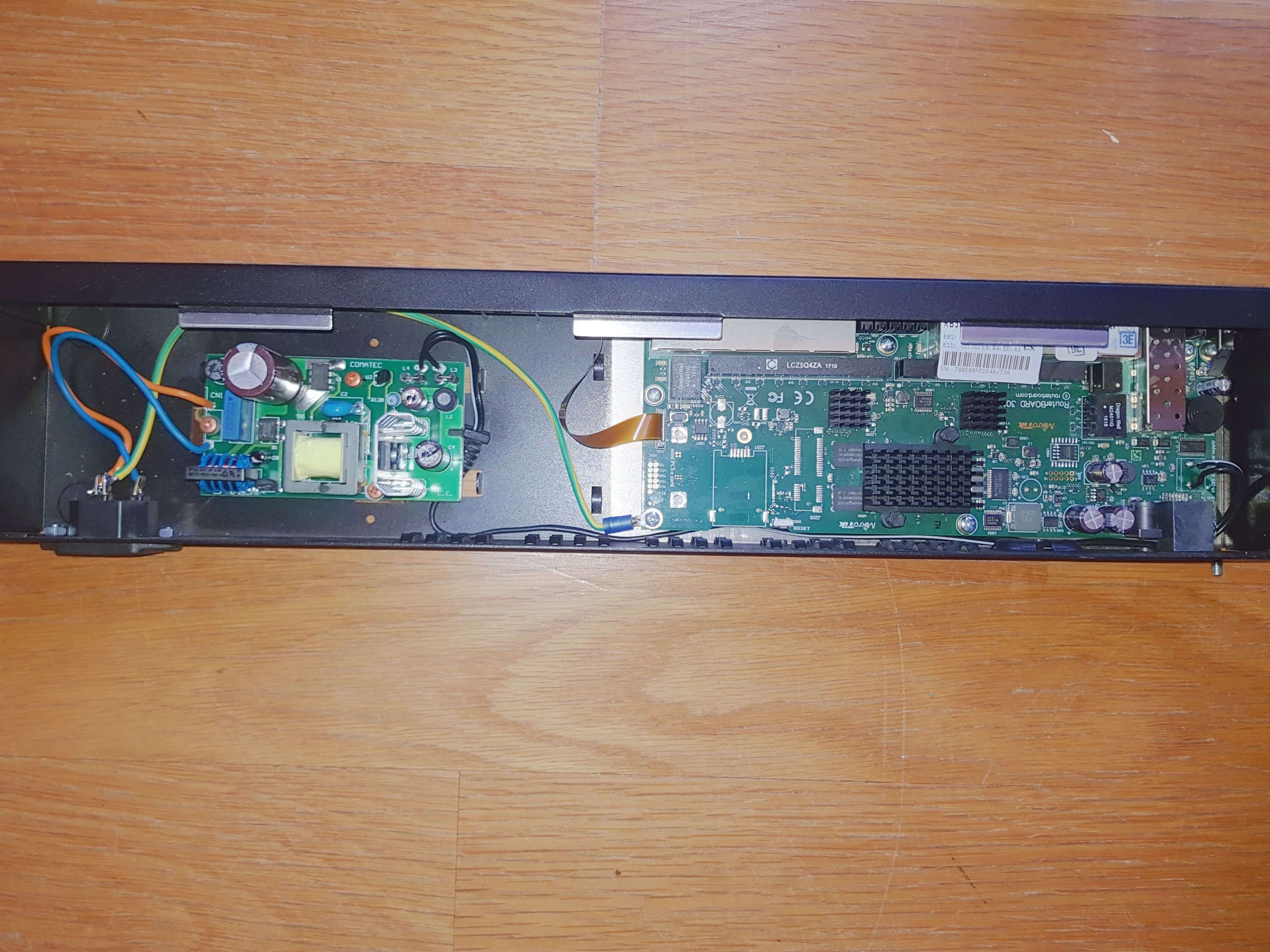

On the mainboard side, be sure to use a soldering iron with at least 50W, especially on the “ground” side, the heat is dissipated across a large area, so you want to be able to heat the soldering point in a few seconds.
For those who wonder, there is a fuse, it is the black round dot on the upper left corner of the PSU, so there was no need to add another, discrete one. An R/C filter is also already part of the PSU. Grounding is done over one of the screws that fixes the mainboard to the enclosure.
I glued 3 small epoxy-board squares on the enclosure (arsenic-based instand glue, so they would never ever come off), then I pre-drilled the holes (2,5mm) and used self-drilling 3mm screws to fix the board, ensuring enough clearance on both top and bottom of the enclosure.
I used a salvaged 24V, 1A PSU. This one is open frame, so it is absolutely essential to put a sticker on the enclosure stating that there are no user-serviceable parts inside, and that there is a risk of potential electric shock, possibly lethal!
I did not cover up the input jack because I use it as a power output to feed another device (check the total power consumption, it shall not exceed the power supply’s capacity!
Disclaimer: This is potentially lethal, so I explicitly discourage you from building it on your own, unless you really know what you are doing and take full responsibility for that! There is a reason why Mikrorik did not sell this device with an onboard PSU! I am not responsible for any damage, including, but not limited to, injuries and/or death!
