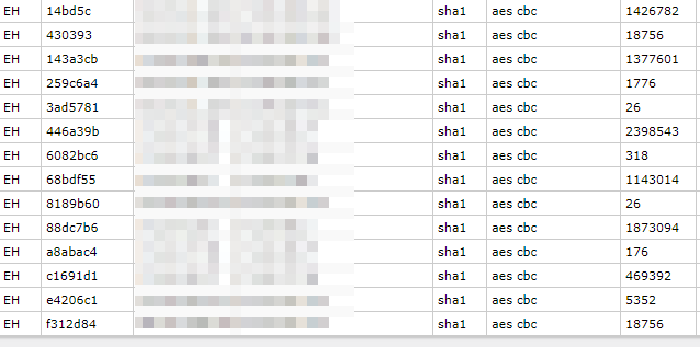

I’ve install 6.43.1 on a 3011 but the IPSEC HW accelartion does not seem to work, it works fine on 750r3 an 1100ahx2.
Installed SAs of the 3011
Installed SAs of the 1100
One of the conexion is between the 1100 and 3100. On the 1100 side has EH, but on the 3011 has only E.
Any ideas?
For first sight might the problem is:
On your captured picture is see 192 bit size encription keys.
In the table in the manual, there is a * reference in the row for RB3011, which says
In your installed-sa list, I can see “192” in “Encryption Key Size” column. So change the aes key size to either 128 or 256 bits and try again.
Thanks!! Setting the default ipsec proposal only to allow 128 or 256 worked.
