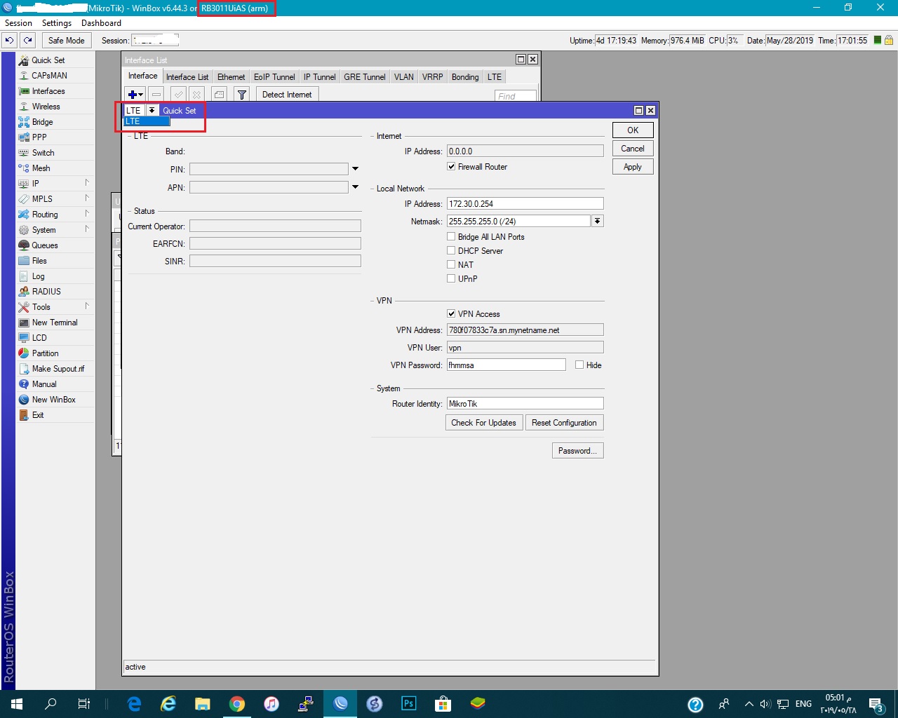

Hi
I have put USB LTE in my RB3011 and I have removed now, but the Quickset still show LTE in it and “ethernet” option disappear and no more option in it, only LTE
Thanks All

i have the same problem
my router is hEX
Note that: my friend also has a hEX and the problem didn’t appear for him..
i believe that that problem has appeared after i connect my phone to the router and enabled the Tethering.
The problem appears if a phone is connected via a USB connection, and activating the phone as a LTE modem or connecting a USB LTE modem dongle

I have the same problem on my RB3011uias…:wink:
