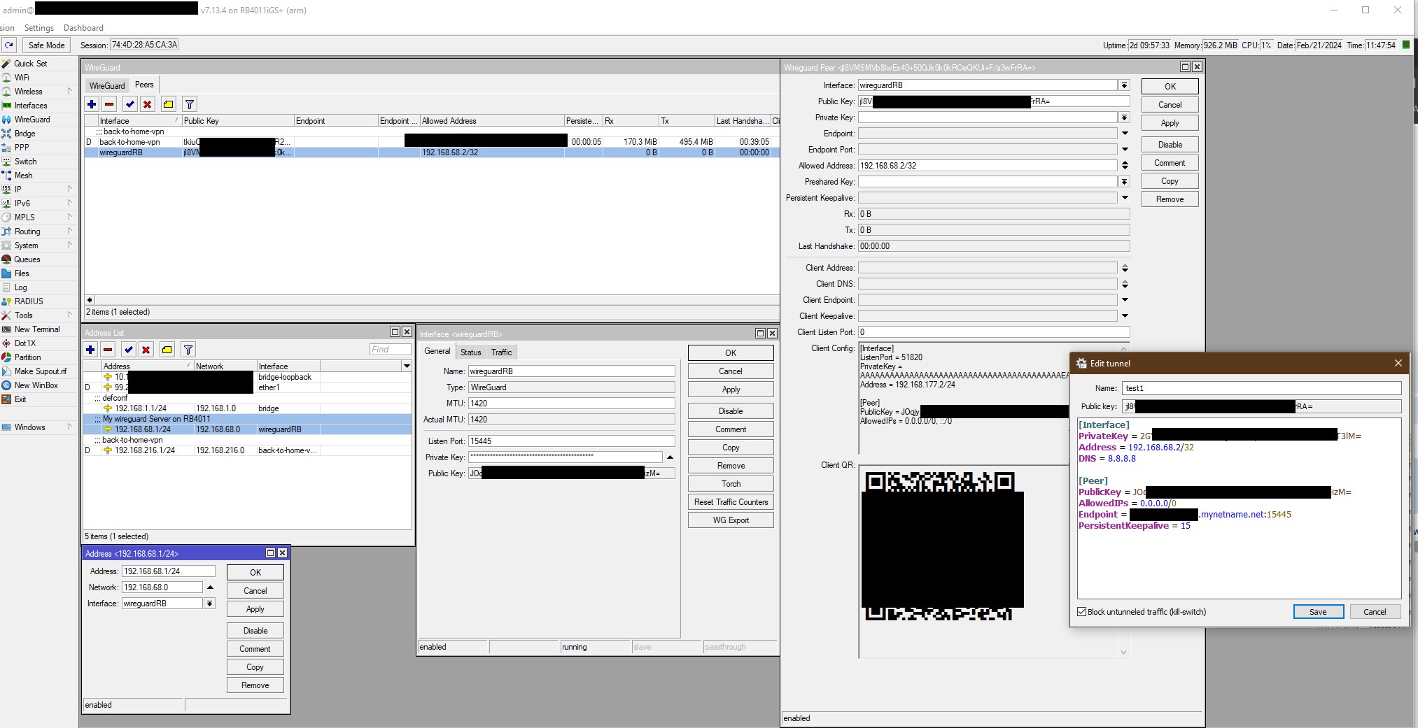

@Mesquite,
I followed your guide & youtube videos but WG server setup NOT successful on RB4011. Watched all videos - non required to make changes in firewall in RB4011 for Windows 10 laptop or cell phone. I tried again and again but no connection.
See attached screen shot:

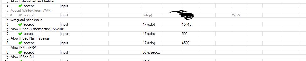

Thanks for quick reply:
Item # 4 - ISP2 - ether10 - Not in use anymore. But planning get again. Pl help me to revise it.
Item # 5 - winbox excess from WAN - I disabled it now. like this:
is that OK or I need to delete that line?
Item # 6 - ??
Item # 7 - added wireguard handshake - see abobe snap
Item # 8 - ??
