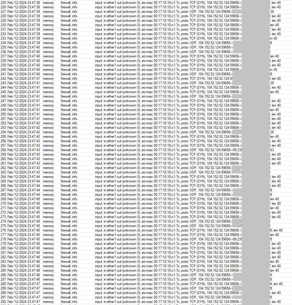

I’m getting this : input: in:ether1 out:(unknown 0), src-mac 00:17:10:10:c1:7c, proto TCP (SYN), 3.17.141.240:53606->XX.XXX.XX.XXX:3414, len 52 and I’m worried.
See snapshot

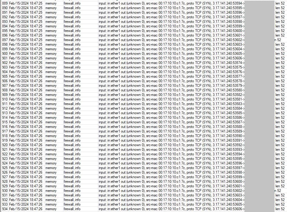

The logs in question are due to turned on logging on some of the firewall rules, an input chain one. For the secondary questions, in theory there should be no disturbance of the IKEv2 connection and you could set Back to Home VPN server on the router with CGNAT and add your family members as clients + no need for Wireguard site-to-site because this VPN is so flexible that it could travel through the IPsec tunnel
Thanks @TheCat12 for the reply.
Who is 104.152.52.24 or 3.17.141.240? Why it generating traffic from in side to out?

As for the IPs you asked about, the IP beginning with 104 belongs to Rethem Hosting LLC ( might be a CDN for streaming services) and the other belongs to Amazon.

Thanks gabacho4 & TheCat12 for quick replies. It’s good that traffic from Amazon’s project & I don’t have to worry.
