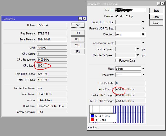

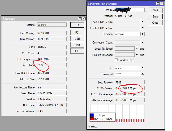

Just finished bandwidth test between two 4011 with CRS317 between them. All connected by 10G SFP+.
4011 are connected by tagged vlan.
Test 1
Bandwidth test with UDP packets
MTU 1500
Maximum 4.3Gbps
CPUs around 25%

25% on a quad core CPU device means 1 core was running at 100% whilst the others were idle.

EoIP seems to be single-thread then, where the Kernel possibly mistakenly assimilated Btest and EoIP to the same thread - anyway, (4 - 1) threads which can go to any other feature.
I think btest is limiting your results.
He agrees. If you want to receive real values, then miktorik should not generate traffic in any way, it should pass it only through itself(himself). The CPU resources are spent for generation of traffic at what considerable.
