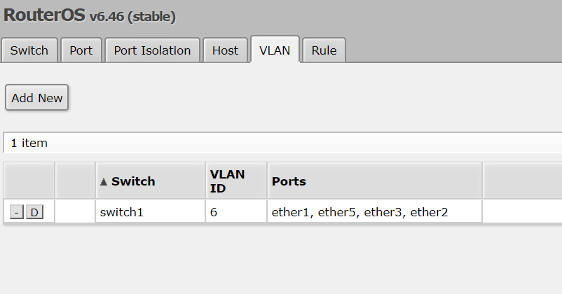

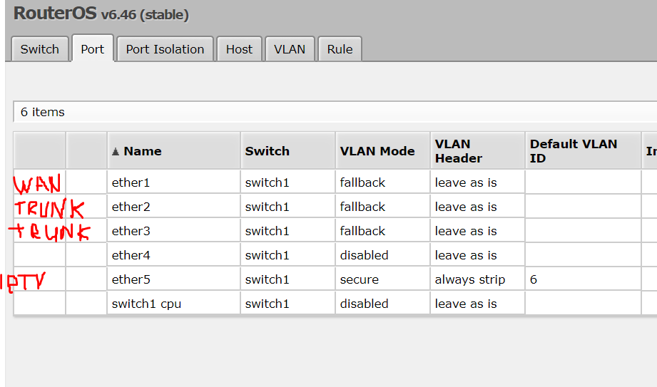

I’m still learning how RouterOS works… Could someone please advise how would I move this VLAN (it’s from hAP ac2 which worked well for me) configuration to rb4011igs?
ether1 connected to WAN. It receives untagged packets for internet and VLAN 6 for IPTV.
ether2 and ether3 act as trunk ports and pass internet + iptv further.
ether4 - connected PC
ether5 - to watch IPTV via STB.

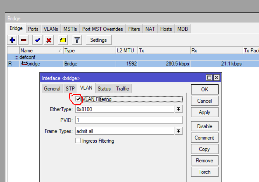

So basically I needed to enable VLAN filtering on a bridge:

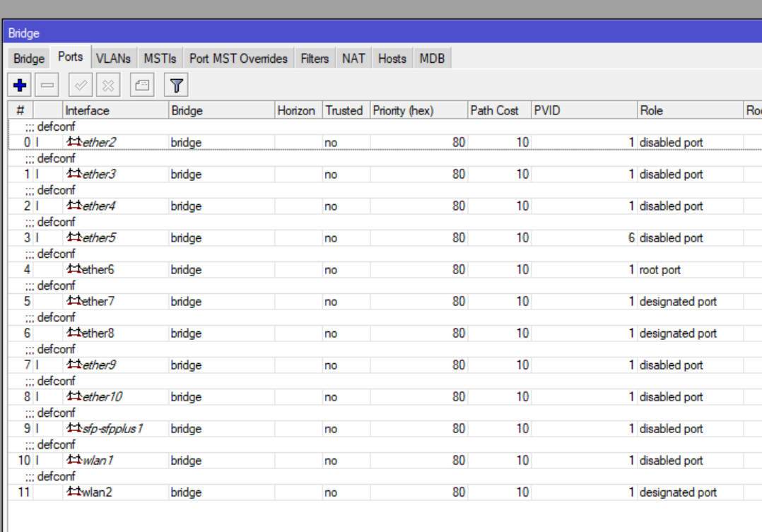

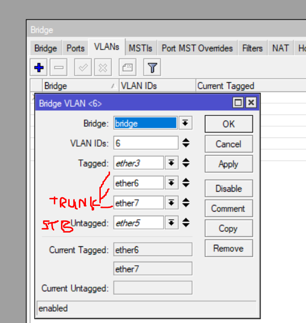

I also managed to create trunk and access ports like here:
The only issue I’m facing now that I don’t see ether1 (WAN port) on the bridge (so I could create trunk, access ports). I can add it but I think it’s not there for a reason? Is it secure to add it? Or there is another way to do it right?

Just add the ether1 port to the bridge. It is important to set your vlans in two places. You mentioned one, untaged port must have additionaly set their PVID in ports tab under the bridge settings.
