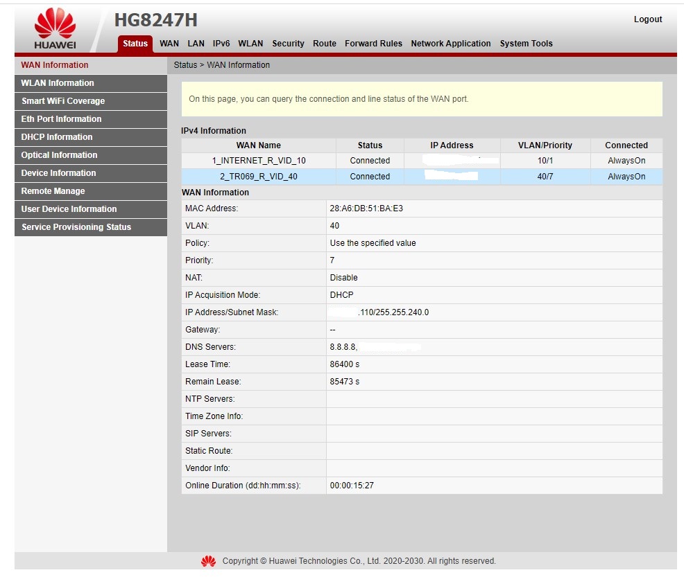

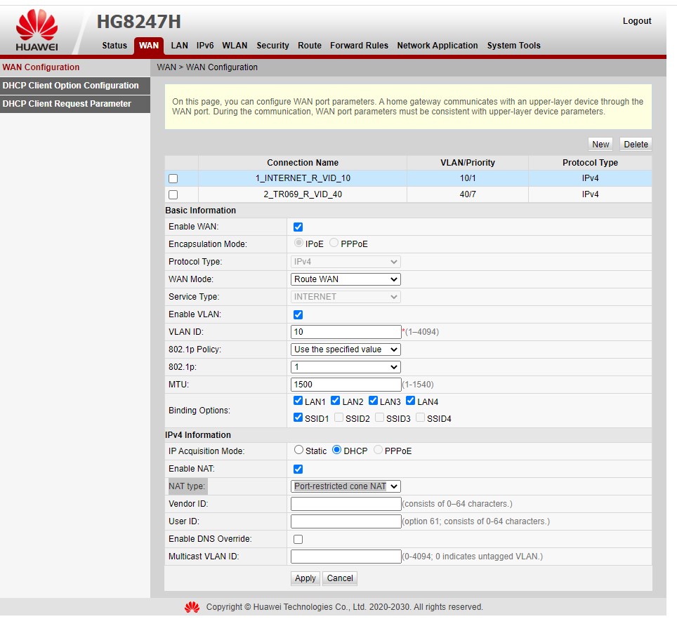

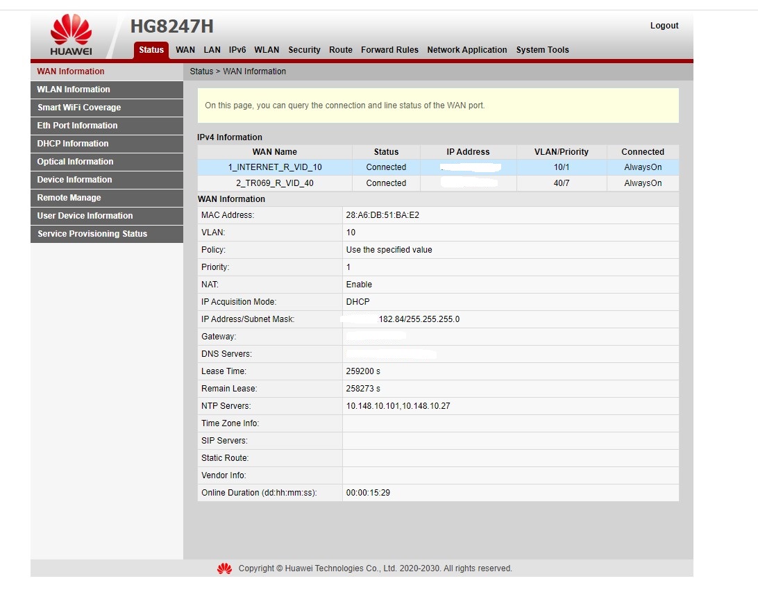

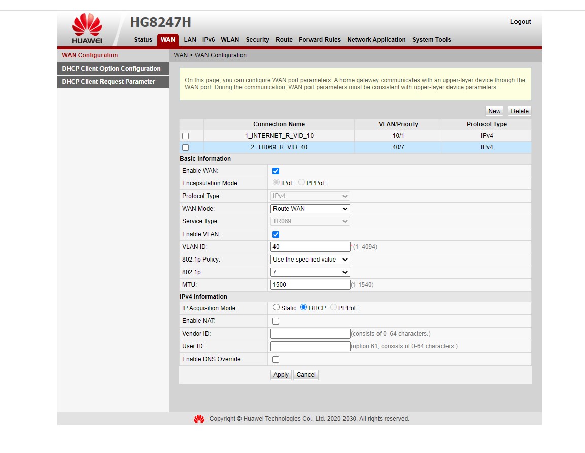

I have been trying for 10 days to set up Mikrotik for internet connection, but I failed. Huawei uses IPoE for connection. The settings are in the pictures in attachments.

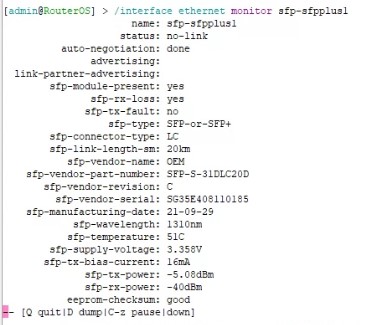

You bought an ethernet SFP module, but your isp uses gpon.

Other than that, the Huawei setup shows that your ISP uses a VLAN to provide internet. QuickSet doesn’t support this (yet?), so you’ll have to use the advanced configuration methods. To give you the necessary commands, we’ll need the starting point. So once you have the proper SFP, reset the 4011’s configuration to defaults, open a terminal window in Winbox or WebFig, type /export file=default and press Enter, then go to the Files section, download default.rsc, open it using a text editor, remove the serial number and post the rest here between [code] and [/code] tags.

As far as I understand about GPON, that is impossible. Am I right?
Mikrotik has apparently withdrawn their own GPON SFP (the one you have found on their website) for overheating reasons, but there seem to be other SFPs that are in fact miniature GPON modems, except that their electrical interface facing towards the router is not the usual Ethernet one but the SFP inner interface, such as https://www.aliexpress.com/item/1005004867364829.html I have never tested it myself, so be careful - check at least the wavelengths. And whereas the cooling surface seems to be extended here using the 3D structure, it may turn out to suffer from overheating too.
