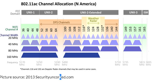

XXXXXXXX and Ceeeeeee are very wide (160 MHz bandwidth). You will need at least some DFS channels to find a block of channels that is 160MHz wide. And those DFS channels might include 120-124 or 128, so your AP will then be silent for 10 minutes after every change to the 5 GHz. Not all end-user devices are capable of using all channels.
Do you really need the 160MHz bandwidth? I would rather go for 80MHz, or even 40 MHz. (Ceee or Ce) with dual spatial stream (866MHz and 400 MHz interface rate, 50%-60 data rate)
Forgive the noob question, but does the 160GHz DFS selection preclude slower clients from connecting at 80GH, or 40GHz. If it doesn’t, wouldn’t 160GHz be a better (more encompassing) choice, even if all devices are brought down to the smallest bandwidth?
Also, for a router that’s in a set-it-up and forget-it, 10 mins doesn’t seem like much, unless you’re suggesting the center channel is changing all the time, no?
