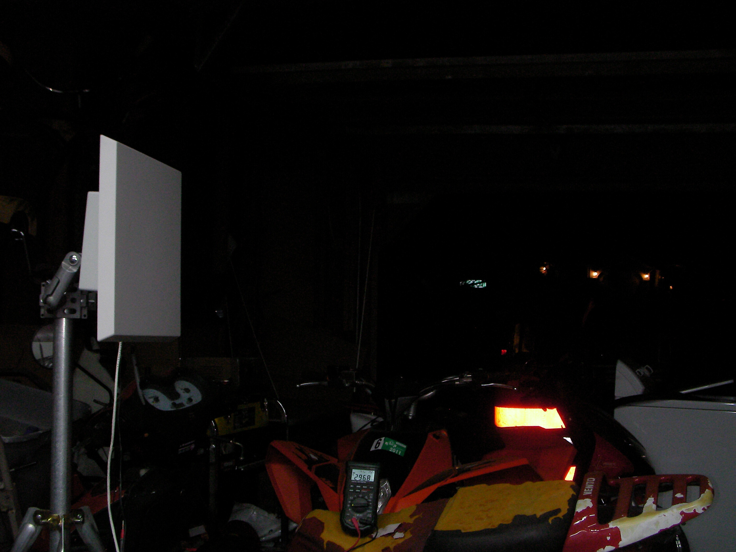

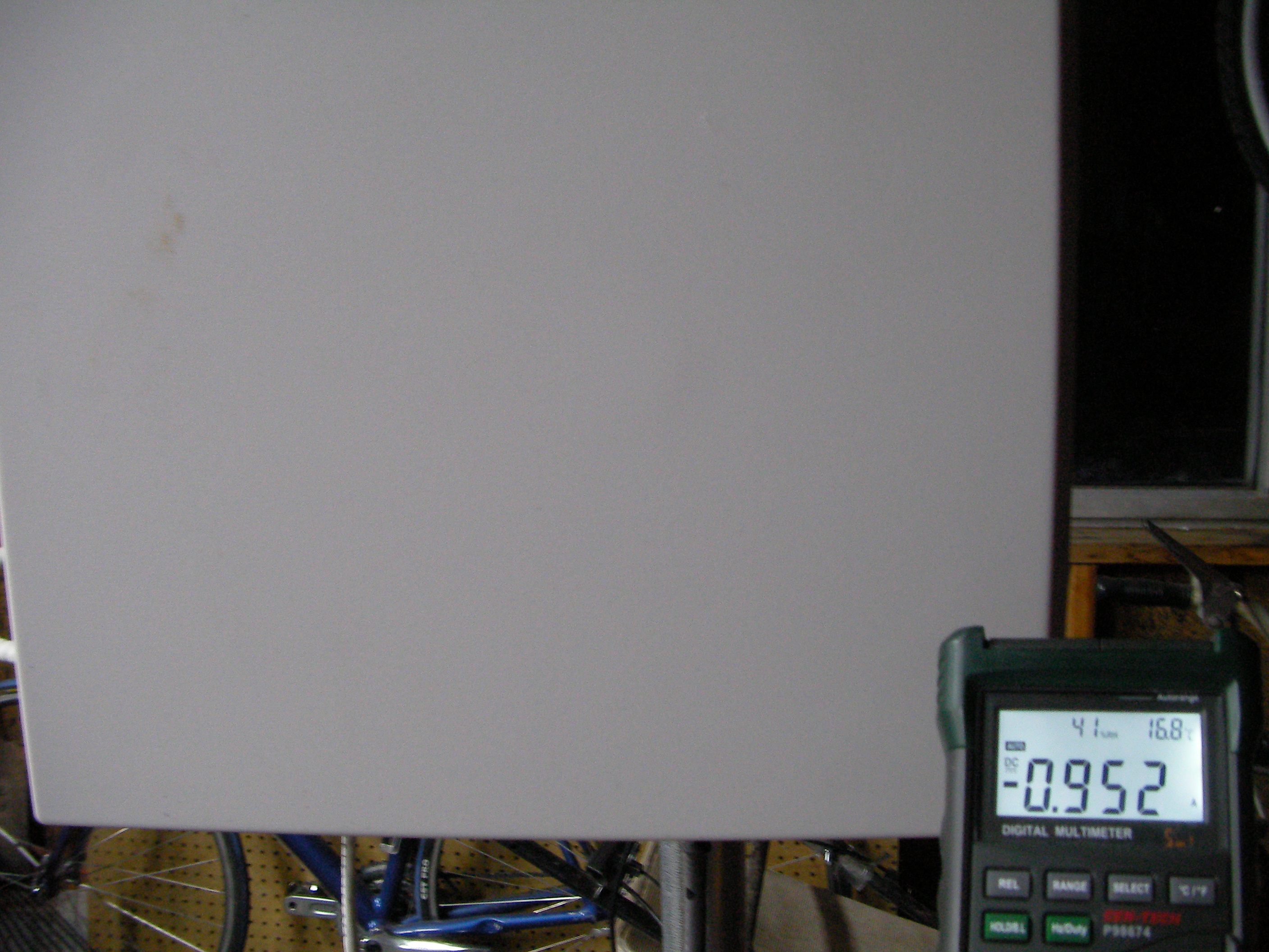

EDIT: I found some photos from when i did a little testing. This is with a plain vanilla RB-411. a 411-U should have very similar results as well…
the first photo is full speed test, using XR9 Wifi card. and reads 952 milliamps
the second photo is under <5M traffic and it is reading 296.8 Milliamps
-Brad
