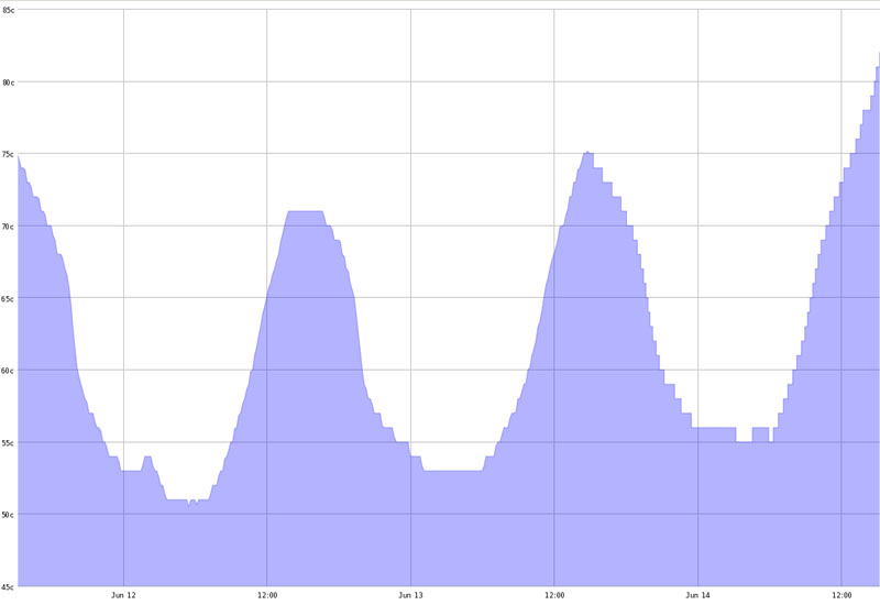

I have a RB450G that is sealed in an outdoor case on a rooftop. The outdoor case is Aluminum and finned. Its 41C outside right now. Should I be worried? The CPU is reporting 81C :open_mouth:

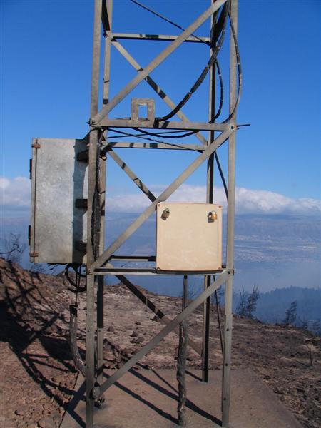

And to put my money where my mouth is. This is what happens to a UT-10 in the event of it being in the middle of a raging fire. As you can see, the PVC pipe into it has been burned to a crisp, but there’s nothing wrong with the contents of the UT10.

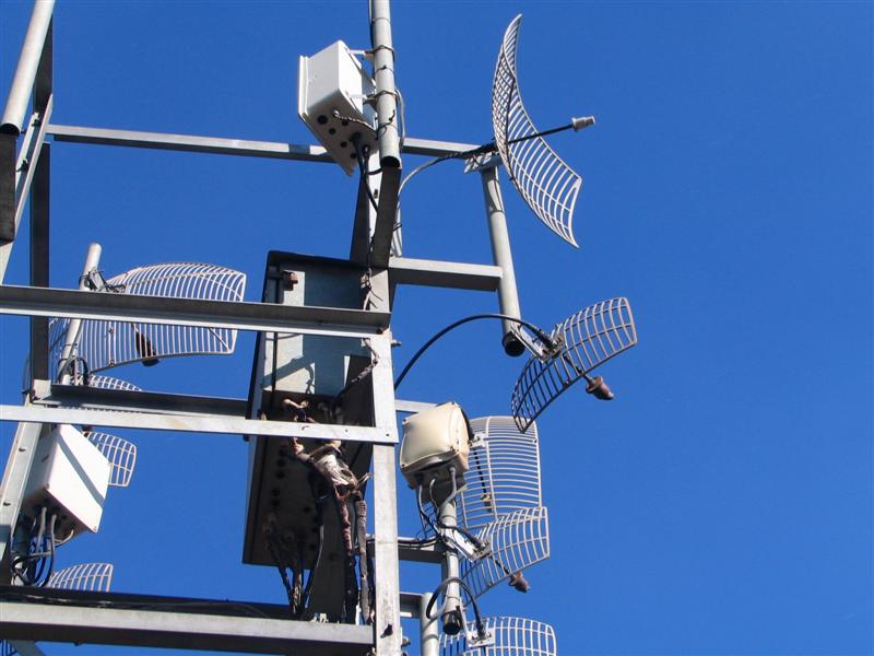

Here you can see some UT7s vs a Gewiss ā€œ208ā€ enclosure. The 208 melted in the heat and the RB ended up fried. The ABB enclosures are still in place today. All I had to replace was the STP and the LMR400 (and a couple of feedhorns).
The enclosures keep the routerboards working when the antennas are covered in snow and when it’s 50 degrees celcius on the side of that mountain.
