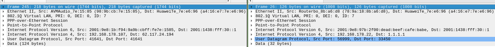

I have been running a separate 1und1 DSL connection with a working DS-Lite/AFTR setup at the same time as trying to get this working with a separate 1und1 fiber connection. At the moment, the RB5009 (right side of the screenshot) is correctly emitting packets to the AFTR gateway-- or at least, the packets look the exact same as what are coming from the working Fritzbox (using its internal traffic capture feature). Just still trying to track down what needs to be altered on the Mikrotik to have it route the return traffic correctly.
Ping’ing 192.0.0.1 from within the tunnel on the RB5009 does not return a response. I have not been able to test from within the Fritzbox, unfortunately. I believe it would return a response if it was working, however.

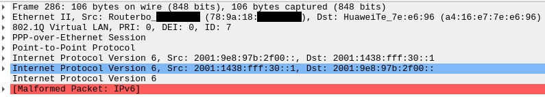

Earlier during the setup, I noticed that the Mikrotik was happy to emit malformed packets into the ipip6tunnel: the packets would look like this attached image.

I think in your screenshot the blue line is strange. The line above is what I would expect, especially knowing the aftr.online.versatel.de address is the destination address in the line above the blue.
