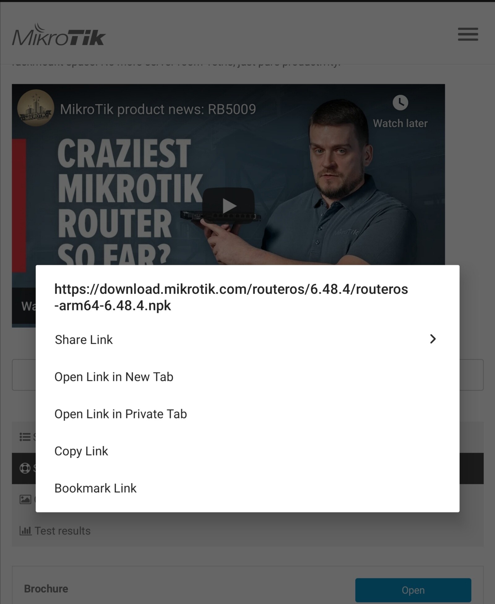

Sorry Normis, the update checker is not mistaken, it Mikrotik who is just sloppy.
I stated this before and it was ignored, as useal.
This I get when click on the RouterOS current release download button on the RB5009 page.
