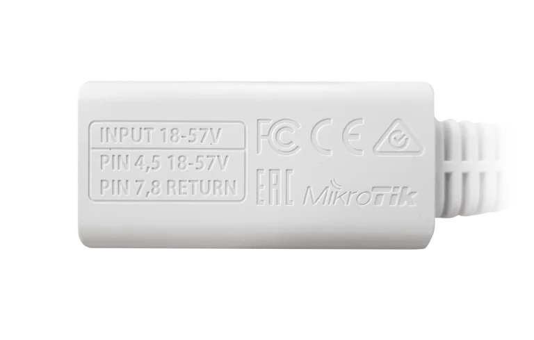

You seemingly somehow missed:
"... notwithstanding being clearly marked on the case and in specs as being 18-57V compatible ..."
https://mikrotik.com/product/RBGPOE
Maybe adding this info to the product page explaining how it is not compatible with "high voltage PoE Auto-on setting" would help people

Still, it would cost (I believe) very little to add on the product page or in an added linked to document a note like:
The RBGPOE is a device intended to be used as power injector, NOT as a power splitter.
It will actually work as a power splitter, but, since it presents a resistance below the one required to be detected as "high voltage" device, the power source (if a Mikrotik PoE out) device will need to be set as "forced on" for it to work correctly or an external resistance needs to be added, otherwise if the power source is set to "auto-on" it won't work correctly and the Mikrotik power source will show the error "Voltage too high".
