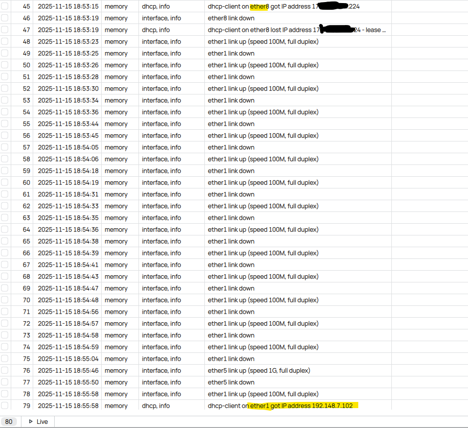

RB5009upr+s+in 2.5G port link up and down as WAN but not other ports
I am planning to get 2.5Gbit internet and want to dabble in network stuff so I bought this router. I only have 100Mbit now but plan to upgrade it.
Internet comes into my apartment via an ethernet cable. No modems or anything like that that I can access.
I used the 2.5Gbit port as WAN and it is stuck in a link up - link down cycle every few seconds.
I’ve set up eth8 as WAN and it works fine. The same WAN cable also works fine with my old router.
The 2.5G port also connects fine as a WAN port if I plug a cable into the old router as the “source”. So I only experience the link down with the ISP’s cable (again, the cable works in other ports and another router):
What I’ve tried so far:
  • updated the OS version to the latest one (7.20.4)
  • turned off auto negotiation
  • removed advertising of other speeds
  • turned off PoE
Same results every time.
I though something was broken with the port, but it does connect and get an address from another router, just not the ISP’s cable. The ISP’s cable works fine, so probably not that either. I am so confused.
Is this evidence of some incompatibility between the 2.5G port and ISP’s hardware? Should I just return the thing while I still can?
Thanks.

I took the router to another location which has 1G connection and it connected with no issues on the 2.5G port (at 1G). So, I assume that the port is fine, after all.
I will try a dumb switch out eventually, thanks for the idea.
I have tried the dumb switch idea and the link was stable. Guess there’s something incompatible between the ISP’s hardware and my router?
In any case, there has been sufficient confirmation that the router is not faulty, which was what I had been looking for. Thanks everyone.
