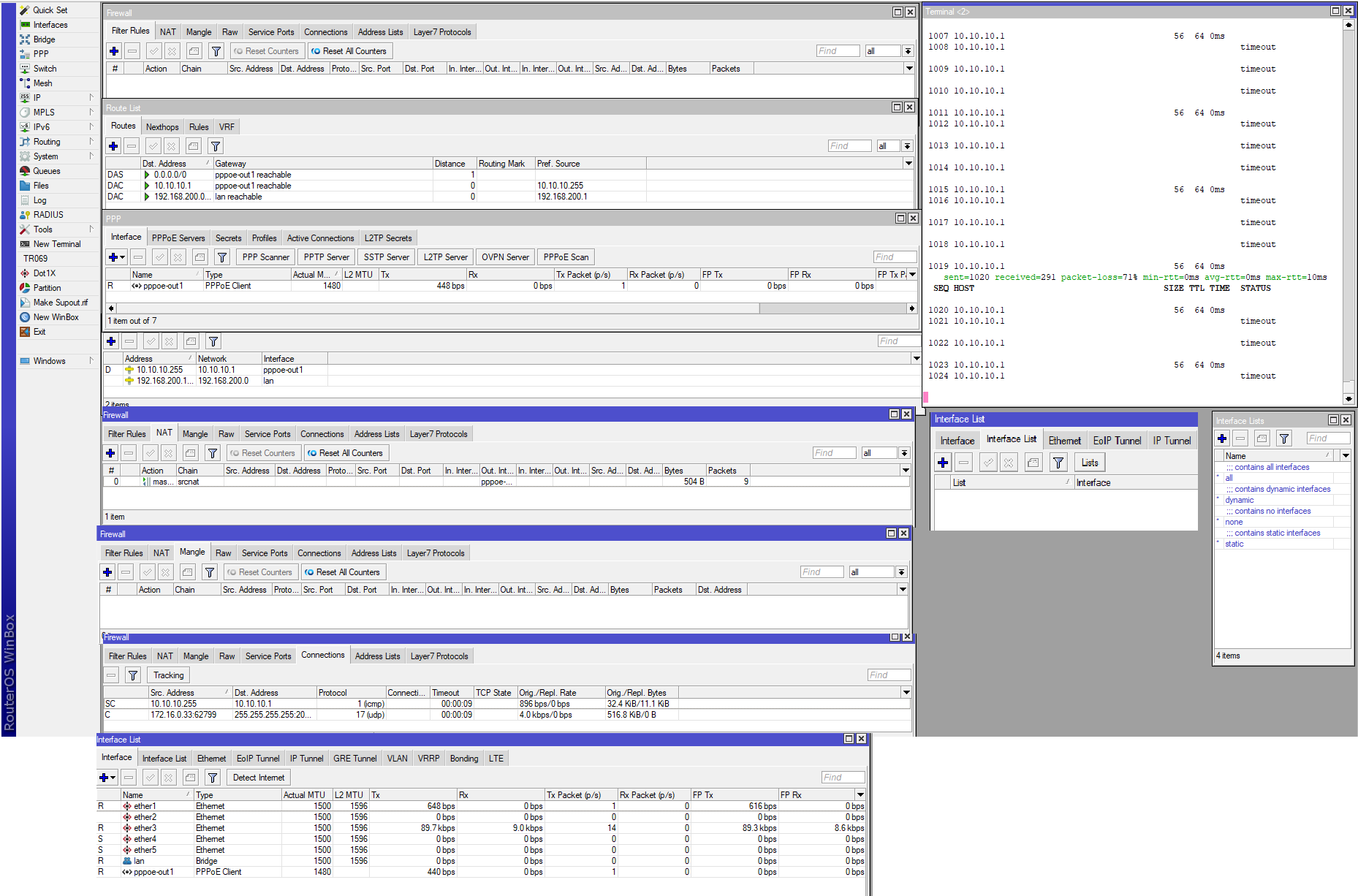

i have one RB750 can not connect internet when use PPPoE. PPPoE connected , but router can not ping to IP address of PPPoE , internet. It loss so much, i have try dial PPPoe by other port 2-3-4-5 but the same issue, PPPoE have status conected and get IP from ISP. But router can not go to internet ,

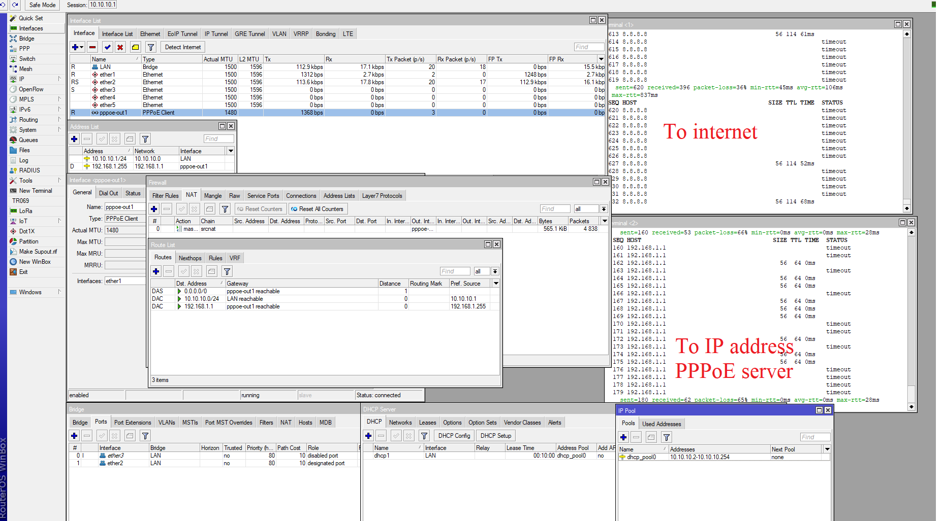

i have try remote interface lit and test again. but the same issue , And i don’t know need add which Rule for this case. Because with this configuration i set up on other devices ( other 750Gr3 ) it run no marl. so only this unit have problem . Do you have any idea for this case?
please try to disable detect internet on all interface and try again
hi , i try change to all port , it the same , loss and loss..
