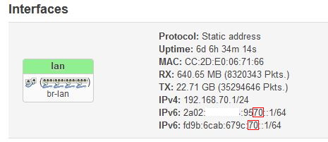

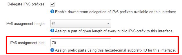

LE: plus the fact that I can do this:
which results in this:
Makes it so hard to switch it back to RouterOS :slight_smile:
