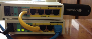

Well, to tell you the truth my initial idea was:
We take 2 rb750up, one is powered via another and handles 3G connection. When 3G modem hangs up (they do from time to time, according to forum), “master” rb750up reboots the other, with a simple scheduled script.
I know that the one with 3G can be Rb411/Rb751. but 750up is smallest and cheapest of those having USB port.
But it’s a bad luck - I bricked one during firmware update…
That’s how it was supposed to look like:
