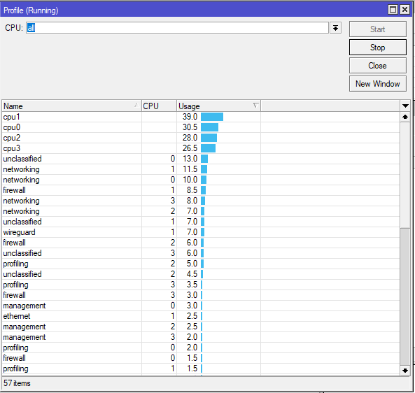

  • during the wireguard testing, run tool/profile, all. Sort by CPU usage top down. What’s on top ?
done.

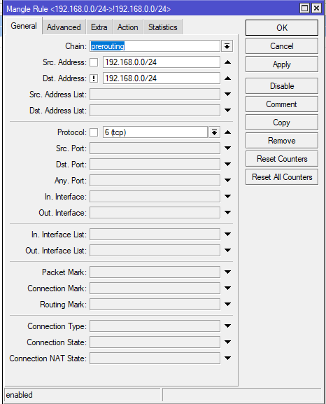

The meaning of this address list (8000 records) is that if the destination (internet address) is within CountryIPBlocks list, then do nothing, go directly, no marks for routing or packets.
(Please note here, 192.168.0.0/24 is added into CountryIPBlocks, so LAN networking works fine).
If destination (internet address) is outside CountryIPBlocks list, then mangle rule does mark routing, and traffic goes outside thru vps (thru wireguard).
The cpu load and upload \ download speed has no changes (!!) if I simply remove comparison against CountryIPBlocks list.
Exactry same speeds! Same Cpu loads !
Seems this simple math compare of 8000 numeric records is just an easy walking a park for this cpu.
Just tried this to be sure (and updated config above not to focus attention at CountryIPBlocks list):

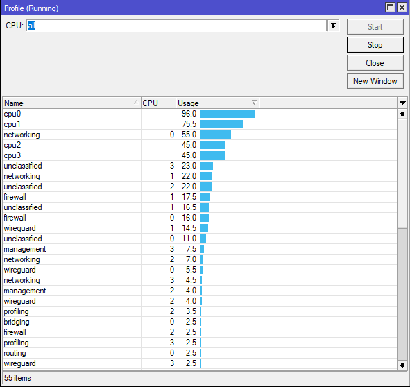

Here is download, 85 mbit:
Here is Upload, 30 mbit:
We are talking why wireguard upload (20-40 mbit) twice slower then ipsec+l2tp upload (65 mbit), both installed on same remote vps, both clients configured within same hex-s.

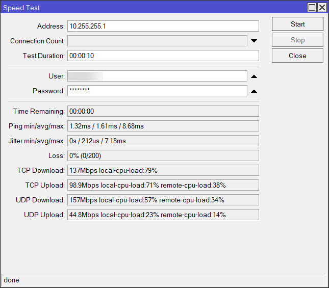

Just did a test with Hex lying around here (not the same but exactly the same CPU/RAM/Storage as Hex-s).
Tests where done from Hex → AX3 → RB5009, all 1Gb links.
1420 MTU as default
Wireguard tunnel between Hex and RB5009, route rule for direct connection between Hex and RB5009 via Wireguard.
And yes, I know I shouldn’t be testing on the devices themselves but for this context, it may do.
Observations:
  • On all 4 tests one of the CPU cores on Hex was maxing out. Networking being one of the highest process, wireguard was way down (never above 20).
  • For both TCP and UDP, download is higher then upload
  • TCP Up went way over 100Mb, down pretty close to it.
  • what I did not expect, was that UDP download was even less then TCP ??
Also did a test from PC via Hex to iperf server on RB5009, about 136Mb, again one core on Hex maxing out (and kept an eye on the interfaces to be sure it was using Wireguard :laughing: )
Disabled route rule between Hex and RB5009 to have reference, reran iperf test from PC to RB5009, 940-ish as expected.
So … 3 things I conclude:
1- There is effectively a discrepancy visible between upload and download. Can’t explain right away why.
2- for TCP (and given your 100/100 line) it should be able to get a bit higher then what you see, I think.
3- You may be hitting the limit of what that device is capable of. It IS still a wonderful device for the price range it’s in, but we can not expect miracles either. Most smartphone processors are a lot more powerful then MT7621A CPU Hex has.
