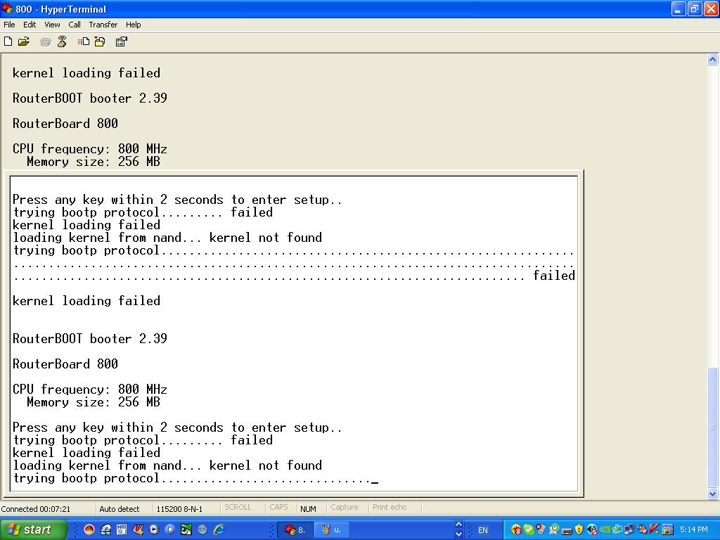

rb800 kernel fail.
The rb800, can not connect with winbox.
no connection with netinstaller.
it gives kernel fail ny using huper terminal
the router is always reset it self may be each 1 min. press to see the att photo
pls advice>>>>>>>>>>>>…
if it reboots each min it might be that you have a netwatch or something like that that was configed, you can from the terminal force it to netinstall, worst case you can netinstall via com, i had an issue with netwatch before that had similar results.
The router is not able to connect with netinstall. only hyper terminal.check above.
As the key within 2 seconds then u can change the boot loader settings, you can netinstall via com port.
