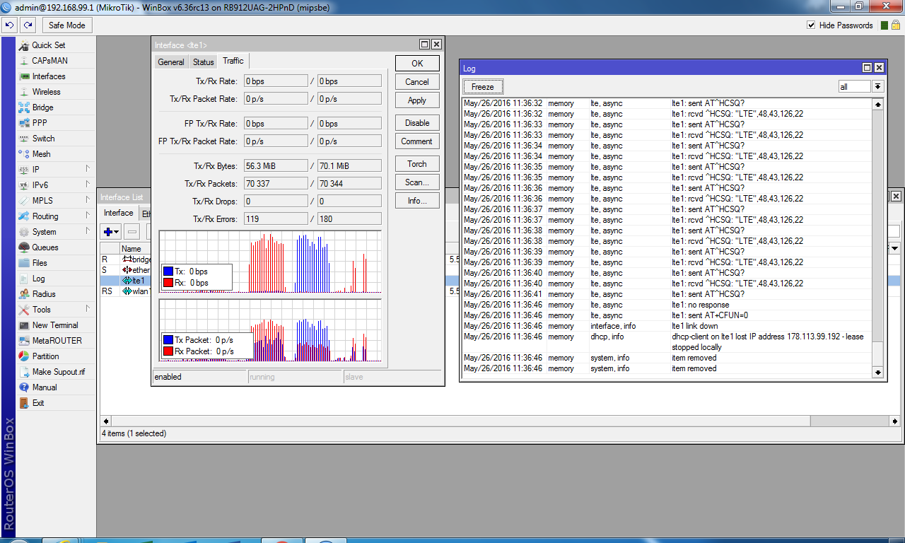

i Took a screenshot from the log

But, I might have a clue here, which is the power supply to the card.
See attached file also. When I put the card into 2G (GSM) mode, it keeps running. I tried to get info from Mikrotik how the power supply part on RB912UAG is designed but so far no answer.
Sounds like while the LTE card is eating more power, it does not get enough.
I will still test also the delivered power supply, maybe using external adjustable supply and higher voltage to compensate the long CAT cable.

my 5cents: me909s-120 works much better after i disabled wireless interface on 912UAG, so, i use it only as lte point and share data using eth1
can’t analyse this config there is too many variants: 1. disabled wireless allocated more power for minipci, 2. bad hardware design, 3. bad drivers, …
update: module works w/o restarts more than day after i disabled wireless hardware
I had the same problem, and (I hope) solved it by disabling WLAN.
