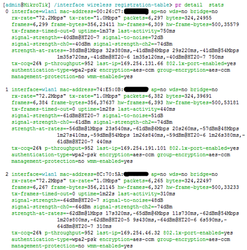

  • [4] In the registration table, the “last activity” counter for all clients gets higher and higher. TX rate drops and drops to eventually 1.0mbps.

The attached file has a registration table snapshot’ed during one of the “disconnect” periods.
