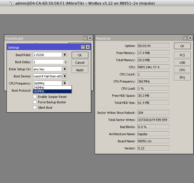

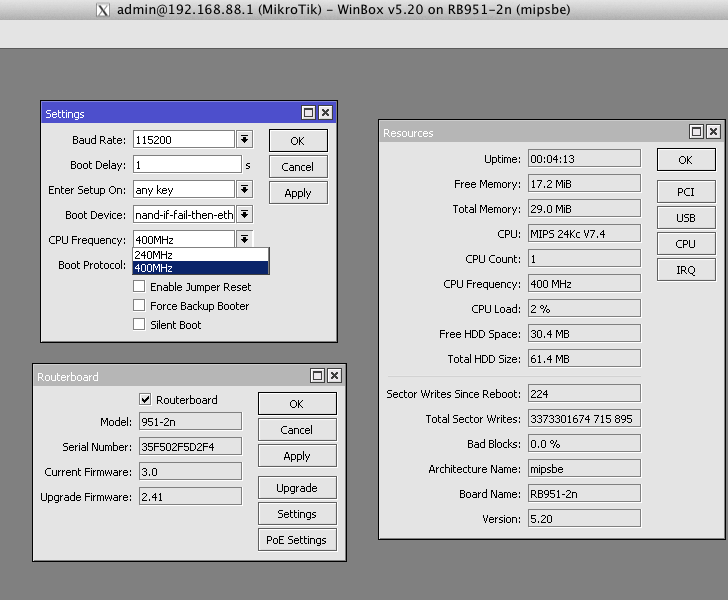

Recently when updated two of RB951-2n the CPU frequency dropped back to 360MHz. Tried downgrade to ROS 5.21 no effect. Only rollback to v5.20 returned 400MHz. Tested on two RB951-2n with Bootloader 2.41 and 3.0. Under v5.20 same boards shows 400MHz.

You were posting here a screen shot in and on the left side of the Recources monitor, we will be able to see
at the CPU frequency is at 400 MHz right now!!! And now I was thinking that you must at first change the CPU
back to 360 MHz or 240 MHz and then you are able to switch it back to 400 MHz can this be!?
In the other direction it will be not running! Because if the cpu is running at 400 MHz it should not be able to switch
the cpu to 400 MHz, this does not making many sense in my eyes.
Please be so friendly and try it out and switch to 360 MHz and then have a look on the settings section that is shown at the right side, so if you find now the 400 MHz setting you will be able to change the cpu clock back as you was expecting
it. Perhaps you were only in a so called thinking false!

Because if you reset or load default config under ROS 5.21 and 5.22 you fallback to default 360Mhz and cannot select 400MHz again. Only Netinstall 5.20 or earlier version would allow to change to 400MHz again.
