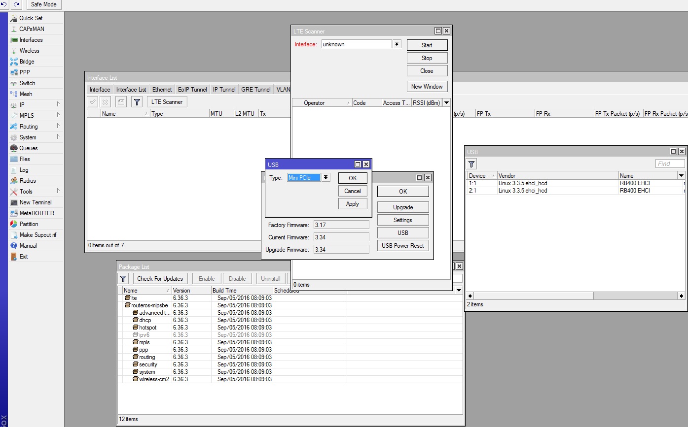

RB953GS-5HnT-RP + LTE HUAWEI ME909s-120 Not Recognized
I bought RB953GS-5HnT-RP and 2 LTE HUAWEI ME909s-120 MiniPCI-e because there stated that they are compatible
but the modem is not recognized

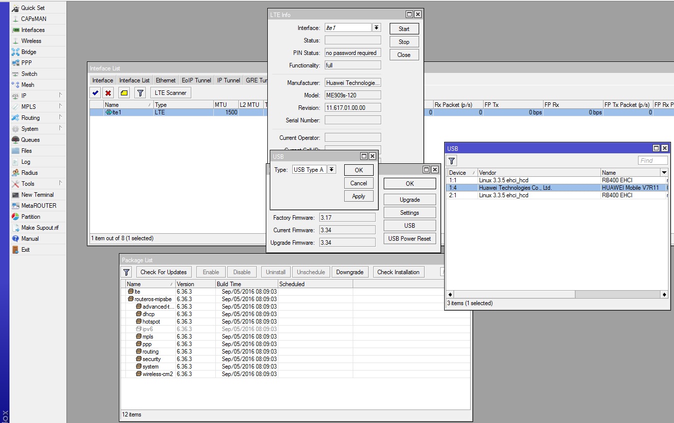

If I use PCIE MINI Converted to USB the card LTE HUAWEI ME909s-120 then everything works
But I need to work with the port MiniPCI-e
please help me!
