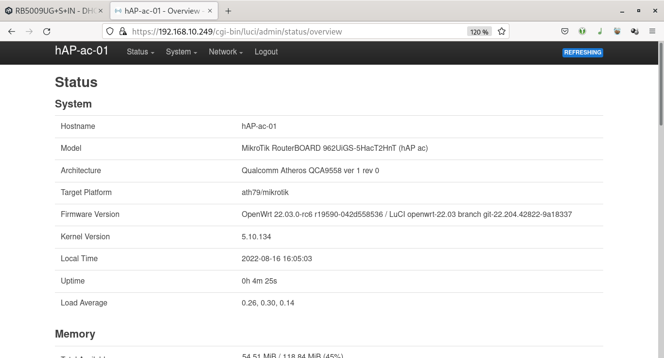

I finally as able to install OpenWRT using bootp support :
  • First booted into OpenWRT 19.07 using bootP and dnsmasq
  • Installed OpenWRT 19.07
  • Upgraded to OpenWRT 20.03 latest rc candidate without keeking settings

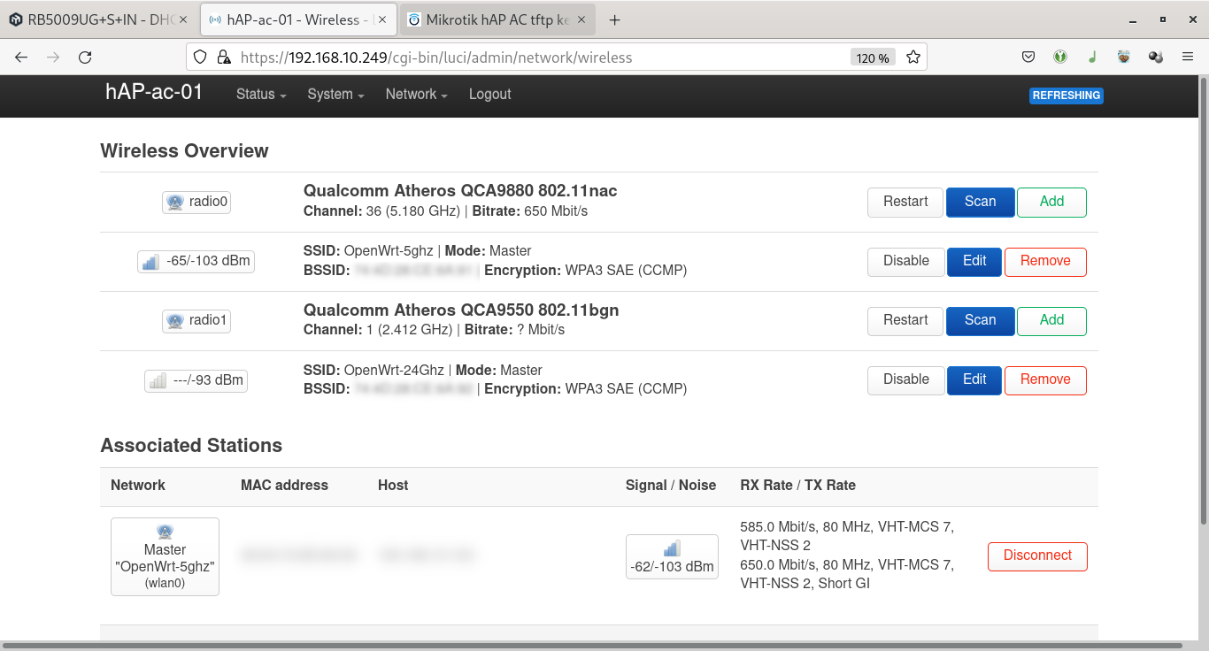

I can confirm that the RB962UiGS-5HacT2HnT (hAP ac) “unofficially” supports WPA3 under OpenWRT. This means that this is OpenWRT reference development of WPA3, not a Wifi alliance certified development. Again, this has nothing to do with Mikrotik.
The reason why WPA3 is not available on the hAP-ac is quite obscure, but it is probably that Mikrotik does not want or cannot go through WPA3 certification and prefers to launch a new device. Maybe some Mikrotik engineer can answer us.

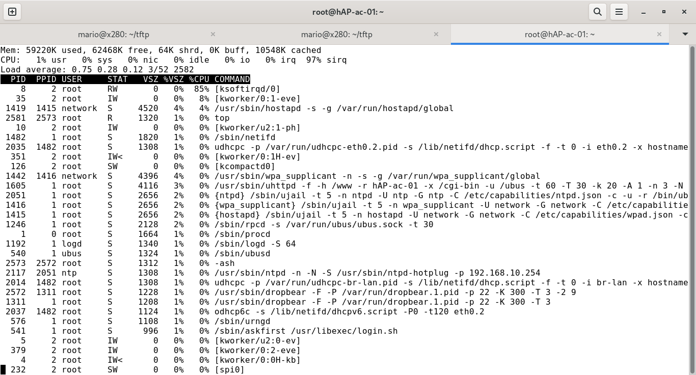

Also, CPU usage is close to 1% as shown on this screenshot. So everything which was written on the Internet about hAP ac being slow and consuming CPU resources, was pure nonsense and is a lie.

The hAP ac does not have 3 radios, it has 2 radios of 3 chains each radio.
Maybe to work only as ap, that CPU is enough.
But with some heavy features enabled will not.
No, screenshot shows that hAP is hitting the CPU ceiling (0% idle) and 85% of CPU cycles are used to service interrupts (ksoftirqd/0 pseudo process; quite possibly triggered by wireless chips). 1% of CPU is used on userland applications, e.g. to execute top command.
I’ve no idea which of (pseudo)processes would show CPU consumption if (kernel!) firewall would have to spend time on packets though. (Note that different FW configuration possibilities, e.g. iptables or nftables or even firewalld, are merely management tools, it’s the same in-kernel firewall engine executing the rules)
I did a similar iperf3 testing using another OpenWRT AP with a quad-core modern ARMv8 CPU and SIRQ shows 20% usage. So I believe that Wireless is a single core process, which needs massive IRQs and eats-up CPU time pretty fast.
The only drawback of the hAP ac is to be single core and adding more CPU cores would probably not help wireless performance itself.
Because modern Linux is nearly real-time by default, I suspect that a high level of SIRQ does not mean that interruption time is used for processing, only that wireless under Linux is running nearly real-time in a single process. Therefore it is normal to have high SIRQ. On the converse, wireless is a cpu-time consuming process.
So IMHO the hAP ac seems to be a nice platform and is not CPU limited when only wireless is concerned. This is why I also like to use APs exclusively for wireless and I prefer to use a separate gateway.
No, by default linux kernel is not real-time at all, it’s still event driven (it is highly optimized and with decently sized hardware one can get impression of real-time operation, but that’s not it) - there’s linuxRT which contains RT patches. The main reason to have k_soft_irq (pseudo) process(es) is exactly because of this: kernel isn’t guaranteed to process everything necessary real-time, so processing is offloaded to non-realtime (pseudo)process which is using real CPU resources to do all the processing.
I guess the only way of increasing wireless throughput without using massively faster CPU is to increase AMPDU and AMSDU … because every packet received over the air triggers interrupt (I don’t know if packets to be sent need to go via interrupts or not) and executing interrupts has some (fixed) overhead. By reducing number of packets (while retaining amount of payload) also overhead is reduced. But that has limit as well. The other possibility is to offload certain functions to dedicated hardware.
