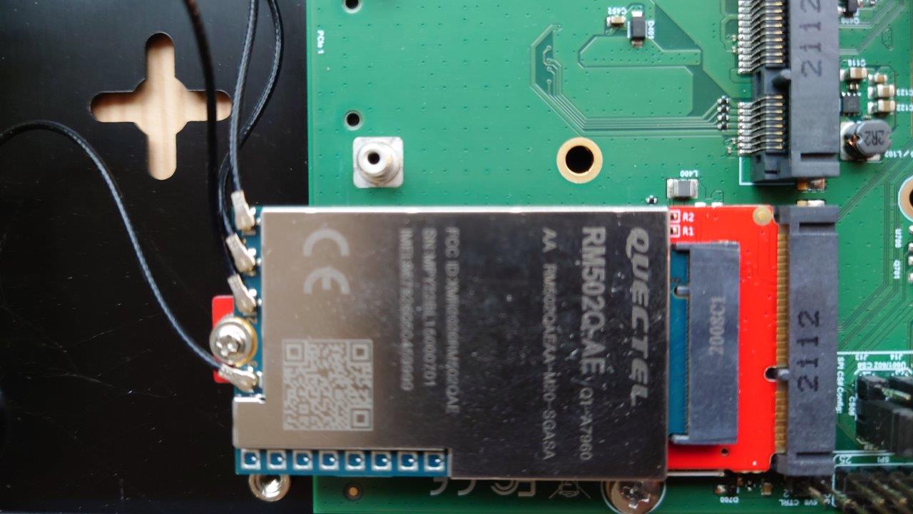

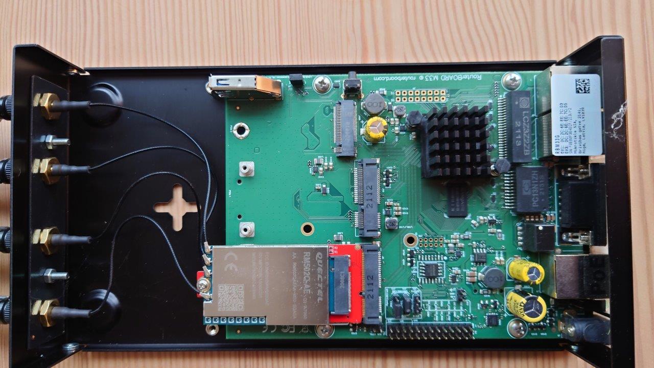

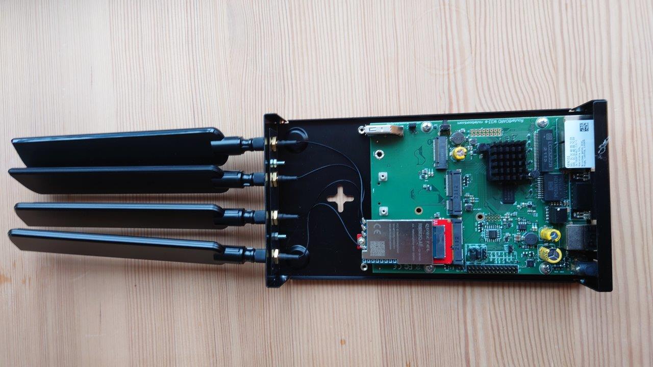

Here are pictures of my device:
-RBM33G
-MiniPCIe to M.2 B key adapter
-Quectel RM502Q-AE M.2 card
-4x MHF4 (?) to RP-SMA pigtails (very tiny little brother of u.fl.)
-4x RP-SMA “blade” antennas
-Oldschool RB433 metal case

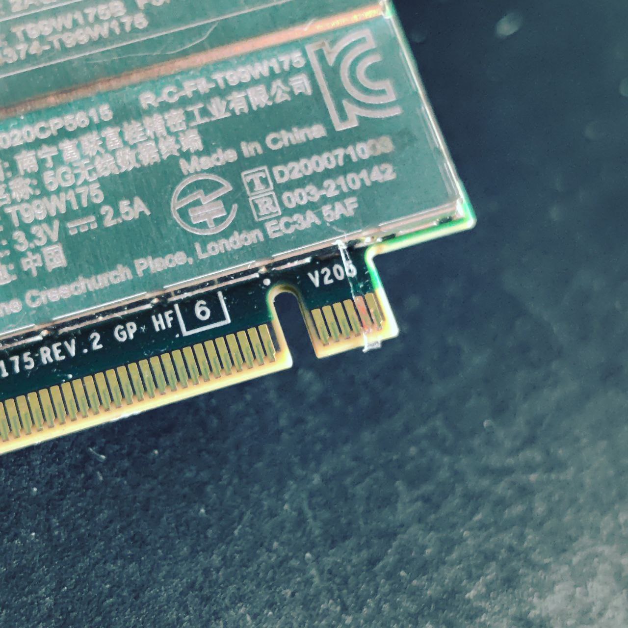

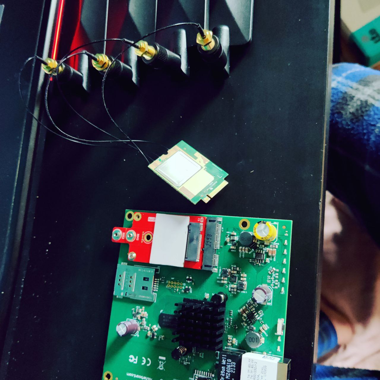

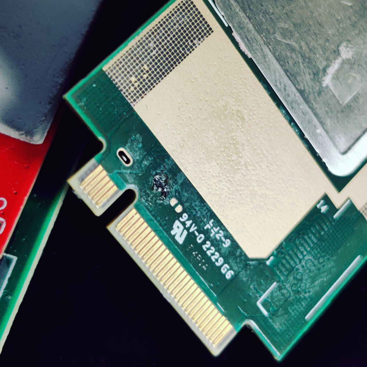

Here is the solution. And this will be revolutionary in future of this T99W175 x55 Snapdragon model.
1st thing what needs to be done is to solder 2 back pins (better option is to use 1-10 kOhm resistor) see picture
2nd this is to isolate pin3 (I taped with clear tape but there are many better options lol)
And dont forget to switch to AT^CUSTOMER=0 (CUSTOMER=1 also has same vid/pid)before you attach to mikrotik. Otherwise it will not recognise different vid/pid
AT-Chat terminal is stable on 7.15 RC2 routerOS.
And use m2 to minipcie adapter (I got the cheapest one on ebay 7$)
I am not regularly checking mikrotik forum due to my busy family life, but sometimes it is helpfull to share information and check for any other updates. On the screen you will see RMB11G but it also work with any other mikrotik models, I have plenty of them different :smiley:
