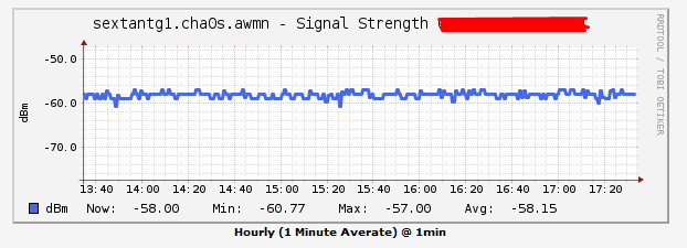

Why don’t you use fixed tx power? With fixed power you get the same signal regardless of the rates. But you need to be careful to not use too high tx power otherwise higher rates won’t work properly (or as I mentioned you might even damage the card).
And maybe even use fixed rates (with a basic 6mbit as fallback)?

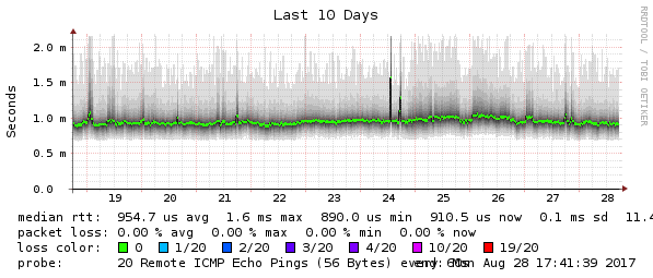

I do that on all my links and the signal level is always flat within 1-3dB fluctuation depending on weather conditions etc.
And also with fixed rates the performance and latency of the link is also more stable and predictable.
Of course in case of interference a fixed rate setting may cause a lot of disconnects.
So constant monitoring is a must in such configurations.
Granted I do this on ptp links only. I don’t have multiple clients per AP, only backbone links.
So now that I think of it, fixed rates won’t help you in your case since you are talking about ptmp links.
But fixed tx power may solve the issue you describe.
