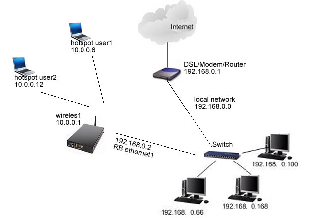

Ok. I have added the drawing of my network.
I am not very advanced with the Mikrotik firewall, so dont know exactly what should i input.
At the moment hotspot users that are using hotspot are able to ping and access local network adresses (192.168.0.0.)
I would like to disable it.
I have put default forwarding off ( on wireless AP), and now the hotspot users cannot ping each ohter anymore (10.0.0.0 network), but they are able to ping my local network (192.168.0.0).
I don’t know why and don’t know how to disable it.
Thank you
