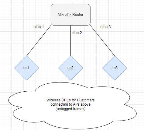

I’m attempting to design a simple way to provide an IP gateway to clients that connect to Ubiquiti APs off of several RB4011’s while also separating (‘separate’ as in at a layer 2 perspective, I’ll worry about layer 3 isolation later) them from the management subnet of those same APs. The setup I have is attached in this post.
Effectively, I have a router that has three physical connections to 3 access points. Those APs have several clients naturally sending untagged frames. I want those clients to have a default gateway that lives on the router, and I want just 1 subnet for all clients across 3 APs. Also, each AP has a management IP that I want in a separate subnet, separate from the client gateway. I figure I ought to tag the frames, so I can do that at the AP level (the router would receive a tag of, say, VLAN100 ingress on each port).
I would like to know how to configure a MikroTik RB4011 for this scenario so that:
  • All three physical interfaces are bridged so they act as layer 2 ports.
  • A layer 3 IP gateway for client connections exists (untagged on ingress and egress from the router perspective).
  • A layer 3 IP gateway for the AP management exists (tagged for VLAN100 on ingress and egress from the router perspective).
From searching and trying things out, I sense that I need… 1 bridge that binds the physical interfaces together, 2 vlan interfaces that act as the IP gateways, and a merging of those VLANs into the bridge. Is there an ideal way to configure this, or better yet, is there a smarter design from a RouterOS perspective to do this? This design is simple to me in a Junos OS and IOS world, but this is the MikroTik world, so I’m open to new designs. :slight_smile:

I got my particular setup to work in a weird way… this is what I did:
add name=bridge80 vlan-filtering=yes
add bridge=bridge80 interface=ether1
add bridge=bridge80 interface=ether2
add bridge=bridge80 interface=ether3
/interface vlan
add interface=bridge80 name=vlan80 vlan-id=80
/interface bridge vlan
add bridge=bridge80 tagged=ether1,bridge80 vlan-ids=80
add address=10.0.80.1/24 interface=vlan80 network=10.0.80.0
add address=10.0.0.1/24 interface=bridge80 network=10.0.0.0
Testing through a Cisco switch, I’ve been able to observe that I get the desired outcome of having an IP gateway [bridge80] that’s only responding to untagged traffic from those three ports (and able to pop the VLAN on egress), and an IP gateway [vlan80] for the tagged management traffic from the Ubiquiti sectors (and able to push the VLAN on egress). CAM and ARP tables on all sides seem to portray the desired output.
I do have a concern about using bridge interfaces as IP gateways with MikroTik, as I hear that traffic is or may be CPU processed. I will ask about that for the RB4011 in a separate article. Thank you very much for the help and resources!
Was this typo introduced when editing for posting?
Your config (with typo fixed) and comments in blue. I would expect ether1 to have untagged on the default vlan 1 (with RB4100 bridge ip 10.0.0.1/24 in 10.0.0.0/24), and vlan80 (i.e. ether1.80) tagged with vlan 80 with ip 10.0.80.1/24 in 10.0.80.0/24. ether2 and ether3 would be vlan 1 access ports in subnet 10.0.0.0/24.
add name=bridge80 vlan-filtering=yes (implicit pvid=1)
add bridge=bridge80 interface=ether1 (implicit pvid=1)
add bridge=bridge80 interface=ether2 (implicit pvid=1)
add bridge=bridge80 interface=ether3 (implicit pvid=1)
/interface vlan
add interface=bridge80 name=vlan80 vlan-id=80 (this creates the CPU’s VLAN subinterface “shim” and the CPU’s end of the “CPU to Switch ASIC” end of the trunk link for vlan 80)
add bridge=bridge80 tagged=ether1,bridge80 vlan-ids=80 (what about ether2 and ether3? The tagged bridge80 is the switch chips end of the “CPU to Switch ASIC” end of the trunk link for vlan 80)
add address=10.0.80.1/24 interface=vlan80 network=10.0.80.0 (this will be tagged vlan 80)
add address=10.0.0.1/24 interface=bridge80 network=10.0.0.0 (this is the native vlan i.e. pvid 1)
If my comments are incorrect, hopefully someone will correct me.
It’s just a typo in the post, not in my lab environment. My apologies; it’s corrected now.
Thank you for this breakdown! Yes, I did eventually include the other ethernet interfaces to that list in ‘interface bridge vlan’.
In your opinion, is there a better way to accomplish my goal (if I’ve communicated that clearly enough) of having a single IP gateway for untagged traffic from these three ports within bridge80, and simultaneously having a single IP gateway for tagged traffic (VLAN 80) from the same three ports?
