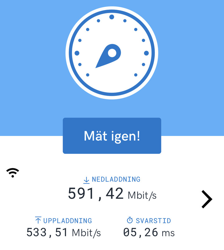

Speed is really good but can be better?! Here’s a test on an iPhone12 on wifi3 interface:

Most on the forum be surprised you got >100Mb/s from any Mikrotik device. In fact, I would have attributed @anav’s
to your decent speedtest results…
