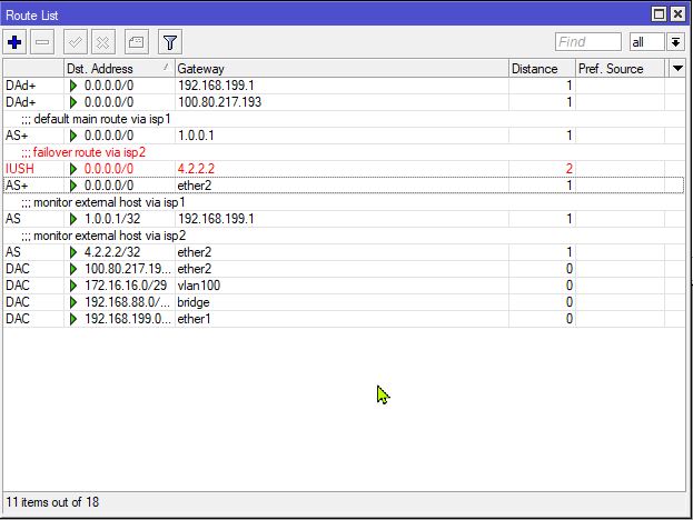

I hope someone can help me with the following, I have one static ip address which will be my default route to the internet on ether1, I also have a SXT LTE which is connected to ether2 and providing a dynamic ip, i followed this tutorial: https://www.youtube.com/watch?v=eTmpBAAW_pQ&t=993s.
The issue I am facing is that I know the gateway for ether1 which will remain static but not for ether2, question is how I deal with this, the nature of the LTE connection means the ip/gateway will constantly be changing. I did the following:
add dst-address=1.0.0.1 gateway=192.168.199.1 scope=10
add dst-address=4.2.2.2 gateway=ether2 scope=10
add dst-address=0.0.0.0/0 gateway=1.0.0.1 target scope=11
check-gateway=ping distance=1
add dst-address=0.0.0.0/0 gateway=4.2.2.2 target scope=11
check-gateway=ping distance=2
my config below:
add comment=“monitor external host via isp2” disabled=no distance=1
dst-address=4.2.2.2/32 gateway=ether2 pref-src=“” routing-table=main scope=
10 suppress-hw-offload=no target-scope=10
add comment=“monitor external host via isp1” disabled=no distance=1
dst-address=1.0.0.1/32 gateway=192.168.199.1 pref-src=“” routing-table=main
scope=10 suppress-hw-offload=no target-scope=10
add check-gateway=ping comment=“default main route via isp1” disabled=no
distance=1 dst-address=0.0.0.0/0 gateway=1.0.0.1 pref-src=“” routing-table=
main scope=30 suppress-hw-offload=no target-scope=11
add check-gateway=ping comment=“failover route via isp2” disabled=no distance=2
dst-address=0.0.0.0/0 gateway=4.2.2.2 routing-table=main
add disabled=no distance=1 dst-address=0.0.0.0/0 gateway=ether2 pref-src=“”
routing-table=main scope=30 suppress-hw-offload=no target-scope=10
This the result of the config:
https://forum.mikrotik.com/download/file.php?mode=view&id=57299
Any help will be greatly appreciated

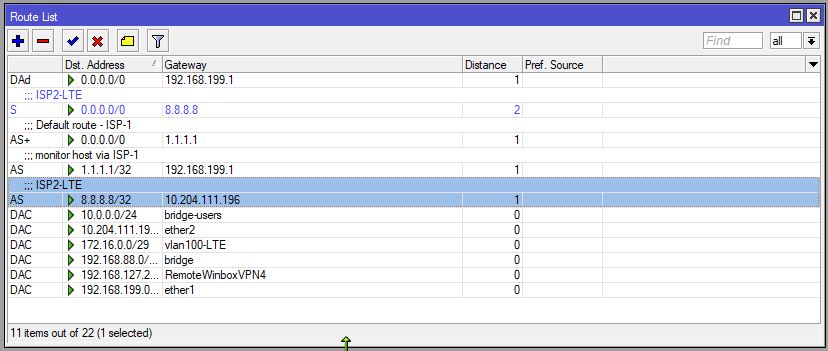

thanks again for the info, I found a scrip on github by misterkrittin, which works, here is the script
[How To Set-up]
IP > DHCP Client > Select WAN Interface > Add Default Route: no
IP > DHCP Client > Select WAN Interface > Advance Tabs > Script: Paste Script
:if ($bound=1) do={
/ip route add distance=1 gateway=$"gateway-address" dst-address="8.8.8.8" scope=30 target-scope=10 comment="ISP2"
/ip route add distance=2 gateway="8.8.8.8" check-gateway=ping scope=30 target-scope=30 comment="ISP2"
} else={
/ip route remove [/ip route find comment="ISP2"]
https://forum.mikrotik.com/download/file.php?mode=view&id=57306&sid=181f37cd912fb88f6817645f087acf2c

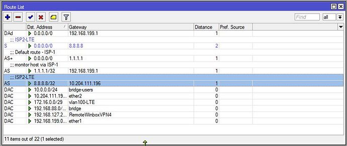

Anyway, I manually added the current LTE IP address (again) with a “fake network” and the idea works as expected for me!
However:
Of course, addition of these configuration items manually is only sufficient to check that the idea works; to make it practically useful, you also have to use a scheduled script to update the manually added address each time the dynamically assigned one changes.
The challenge is that I cannot find any script examples to achieve this, it could very well be my searching ability and/or the choice of words, but is there any chance anyone can point me in the right direction please?
