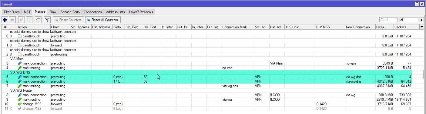

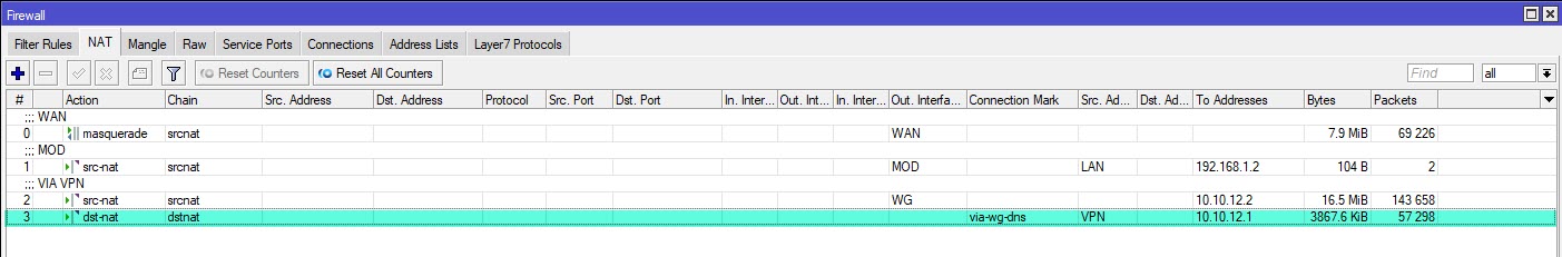

As far as I know, DNS redirect needs also a src NAT for it to work properly, otherwise clients which make dns queries would drop any responses sent by the pi-hole server if it is in the same LAN, since they wouldn’t recognize the IPs they made the DNS queries to. Maybe it is the “MOD” rule I see in the second image you posted above. Is 192.168.1.2 your pihole IP?
Well, You are correct and I have one rule number=2 is my src-nat rule. However, OP config files and topic suggest the pi-hole runs at the same subnet as the LAN. There is a WG IP range that needs to be forwarded too, although the WG config was not clear to me so I did not include that.
hmm, maybe you meant number 1 with the “MOD” text on it. The number 2 seems to be the WG subnet.
The DNS rules are also for forwarding to WG. :smiley:
I didn’t understand what is your Pihole IP.
My dst Nat rule points to my Mk router which in turn points to my pihole server IP.
I don’t have any pi-hole at my home setup. I use an ad-guard container in my x86 ROS VDS. Which provides VPNs like WG and IKEv2. There is a WG tunnel between my home route and this VDS. Most of my internet and any DNS queries are routed through this tunnel.

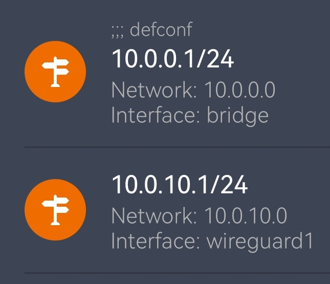

My only home lan is on 10.0.0.1/24
Pihole is on 10.0.0.69
Wg1 is on 10.0.10.1/24

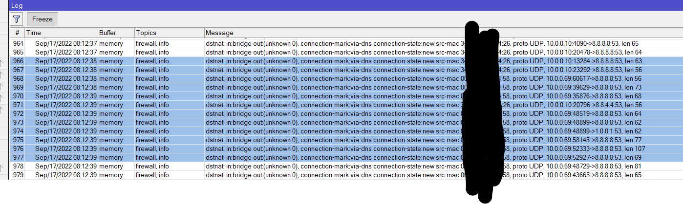

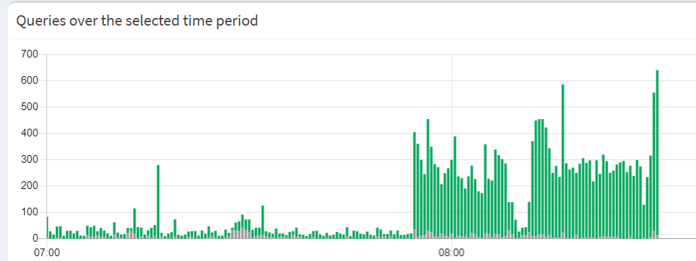

When the NAT was enabled my devices lost internet connectivity.
Any ideas on what went wrong here?

You have to exclude pihole from being redirected … if not, pihole queries get redirected back to itself. You can make exception either in mangle rules or in NAT rule.

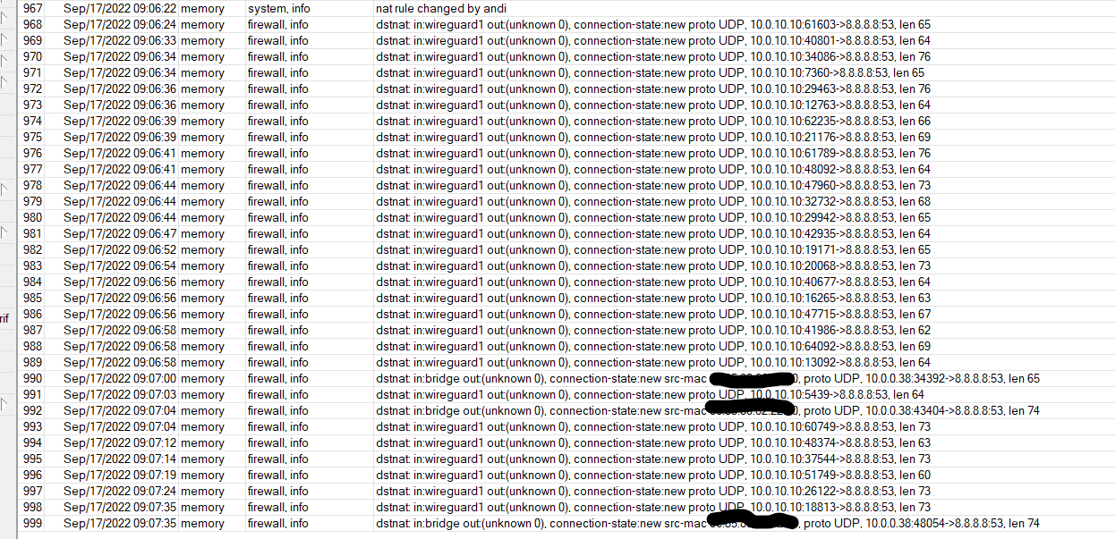

So, it actually turns out that the following NAT rules, in my network setup, works for me;
add chain=dstnat action=dst-nat to-addresses=10.0.0.69 protocol=udp src-address=!10.0.0.69 dst-address=!10.0.0.69 dst-port=53
add chain=dstnat action=dst-nat to-addresses=10.0.0.69 protocol=tcp src-address=!10.0.0.69 dst-address=!10.0.0.69 dst-port=53
add chain=srcnat action=masquerade protocol=udp src-address=10.0.0.0/24 dst-address=10.0.0.69 dst-port=53
add chain=srcnat action=masquerade protocol=tcp src-address=10.0.0.0/24 dst-address=10.0.0.69 dst-port=53
At this moment, I’m NOT using the mangle rules for pre-routing or “New connection mark”.
It seems as if these NAT-rules also catch my wg1 interface, and forces DNS queries to local 10.0.0.69 (pi-hole), which is a good thing!
Or is it??
10.0.10.10 is a wg client outside my LAN.
