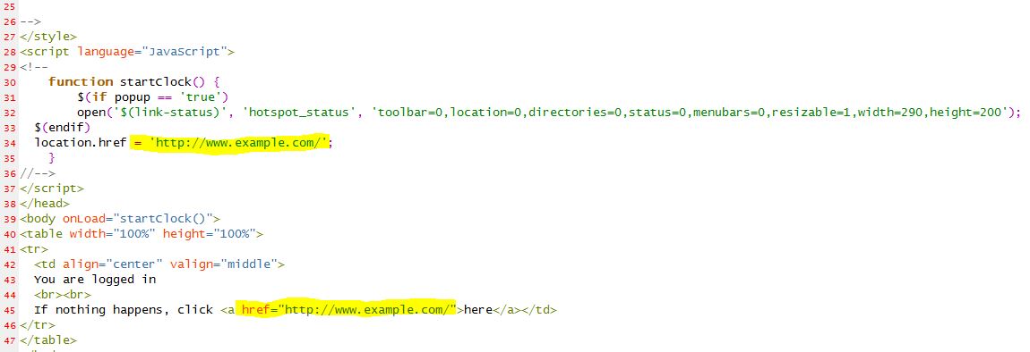

I could be wrong but I believe it is alogin.html you need to modify (short for after login maybe?) The other option is login.html as was said above.

Edit in alogin.html file. Might helpful for others.
