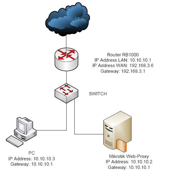

this is the topology of my network…what I want is to redirect all the http traffic to the proxy server…my proxy is not natting, I tried with the two configs but didn’t work as i expected, the proxy gave me an error of looping…I’ve also tried with HAIRPIN NAT but I know it’s not for the same purposes…just gave it a shot
