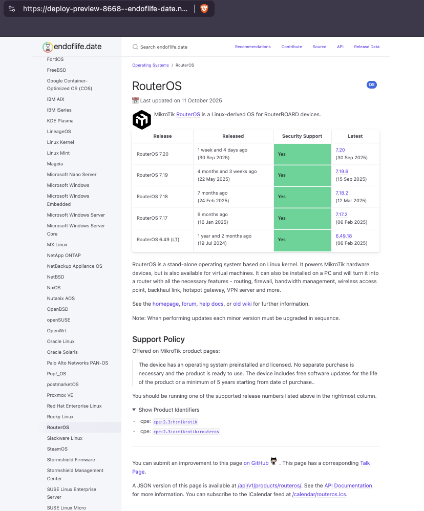

I ask because I am including RouterOS in https://endoflife.date/ for succinct, standardized reporting of latest & supported versions.

For my own amusement, others' curiosity, here's a preview of the support page, temporary netlify build artifact.
On reflection here, it seems like it would be more accurate to say only the stable and long term version "heads" have support
That’s not true. You can upgrade a version to latest stable.
IDK about the site, but some ways noting things like V6 only receive security updates. And, at present, there is no long term for V7. Additionally, MikroTik support policy is limited to bugs and interop/incompatibility, not configuration help.
Correct. Because none of the 7.19.x, 7.18.x, 7.17.x listed will get the fix for CVE-2025-10948.
That is not certain. There may appear a 7.19.7 still. We just don’t know.
