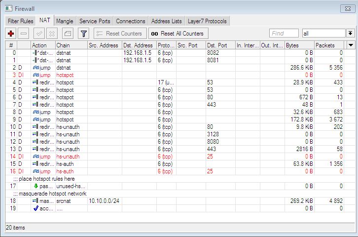

Id like to access the AP Gui remotely. I"ve created a new Port on AP to forward to outside.
Or I guess I may not even need to add a new port on the AP. I believe I can keep Port 80 and add a new port i.e. 8082 to the public interface?
It seems to be pretty straightforward when AP is not behind a Hotspot. But, I’m a bit confused as to which path to take with the AP static IP behind the Hotspot and make it remotely viewable.
Is this proper procedure to access AP remotely?
Any examples?
Thanks[attachment=1]firewall.JPG[/attachment

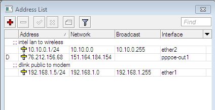

Here's Address config.
admin@MikroTik] /ip address> print
ADDRESS NETWORK BROADCAST INTERFACE
0 ;;; dlink public to modem
192.168.1.5/24 192.168.1.0 192.168.1.255 ether1
1 ;;; intel lan to wireless
10.10.0.1/24 10.10.0.0 10.10.0.255 ether2
2 D 76.212.147.57/32 151.164.184.154 0.0.0.0 pppoe-out1
does this show what your suggesting I do? concerning adding a route.

[admin@MikroTik] /ip firewall nat> print
0 X ;;; place hotspot rules here
chain=unused-hs-chain action=passthrough
1 ;;; masquerade hotspot network
chain=srcnat action=masquerade src-address=10.10.0.0/24

Here's the dstnat rule added recently in regards to your last comment.
2 chain=.... action=accept
3 chain=dstnat action=dst-nat to-addresses=10.10.0.99 to-ports=80
protocol=tcp dst-address=192.168.1.5 dst-port=8081
Do I have that correct?
What's up with rule # 2?
Is that just a glitch? Doesn't do much I believe?

I was pretty sure that you wanted to NAT from internet to your access point, but after the last information it seems that you need to reach your AP from another LAN. You don’t need to NAT from LAN to LAN.
Your hotspot may block the traffic to your AP, so check your hotspot rules. It also looks like you masquerade LAN to LAN. You should add outgoing interface to rule 18 in the first screenshot (the interface connected to your ISP).
