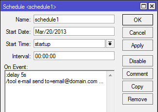

If you want to be emailed when the router restarts, create a schedule that runs on startup:

Do you want to receive an email alert that tells you the time the router rebooted? Something like:
from: email@domain.com
Subject: Router rebooted
Body: Router rebooted on 3/20 at 11:30
If you want to receive email alerts when a particular mac address shows up in the logs, this is possible using the link provided in the second post. What kind of logs are these? Can you paste an example?
ok,
but as the son the schedule?
you have an example?
