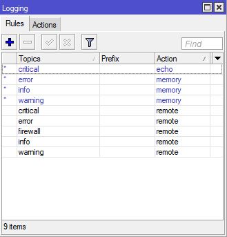

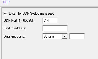

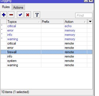

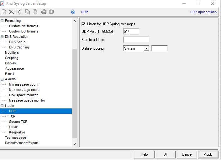

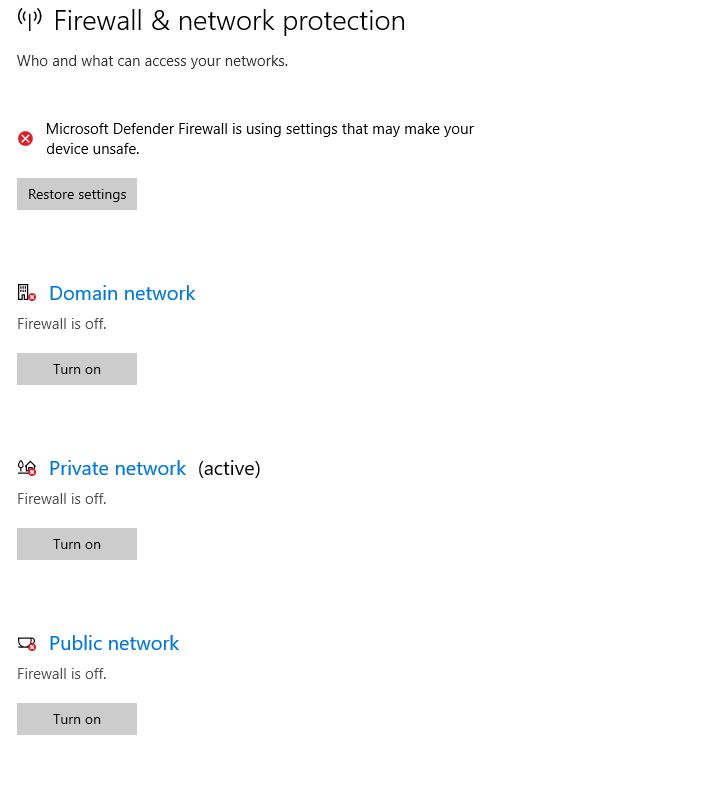

I have been try for 2 days now and can’t get the Mikrotik router to do remote logging in to Kiwi I even Reset configuration and tuned off the Windows firewalls and made sure all the ports settings are right. What am I missing. I have read this post and the settings look the same. http://forum.mikrotik.com/t/how-to-connect-configure-kiwi-syslog-with-mikrotik/110055/9

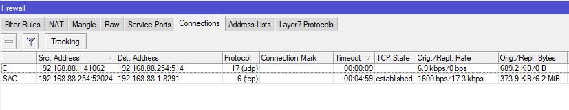

I can see in the Firewall connections it is sending out the data but not getting to Kiwi.

P.S. So I tried a Syslog Generator on a different computer and kiwi does receive those logs so it’s got to be on the router side of things.
So I echo ‘<14>sourcehost message text’ | nc -v -u -w 0 192.168.88.254 514 and kiwi did receive the message. I did not see any logs in side the /data/syslog/tcp or /data/syslog/udp folders.
But kiwi is receiving the messages so its the MT side of things. What next?

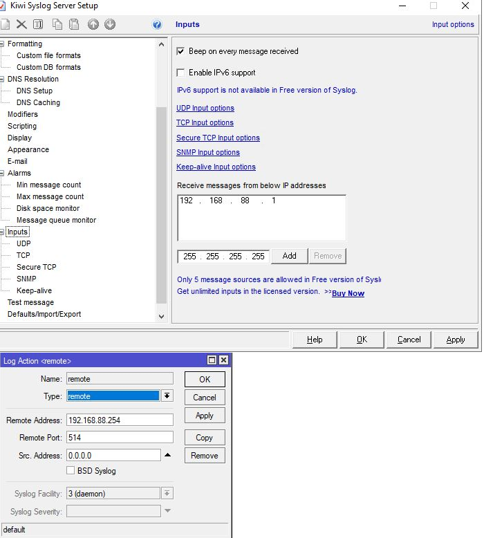

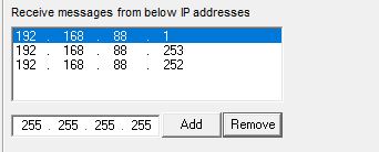

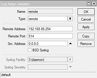

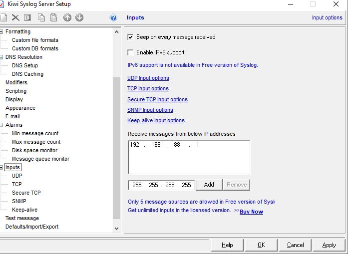

I dont use kiwi, so Im not sure how their filtering works, but you have 192.168.88.1 setup as a source on kiwi, and your logging src-address for the mikrotik is default 0.0.0.0. While the log packet would have a source-ip of 192.168.88.1, kiwi may also be filtering based on the src-address of the log message.
/system logging action> remove numbers=3
failure: can not remove default actions
But I did add your code. And still nothing.

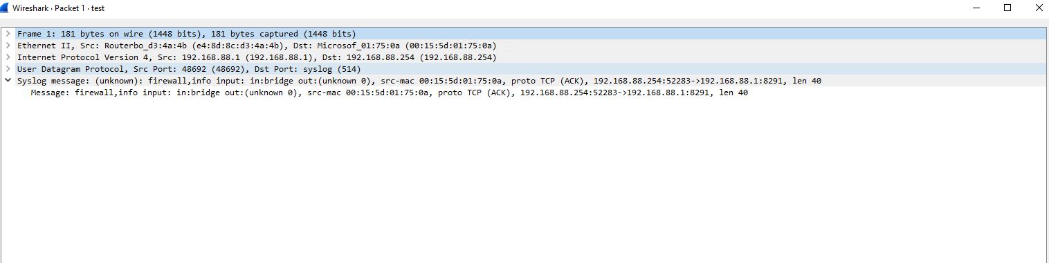

Here are the packet capture from the router but this is a file I saved to the router and then input into wireshark.
I don’t know if those packet actually left the router sense no packet are coming to the kiwi computer from the router on port 514.

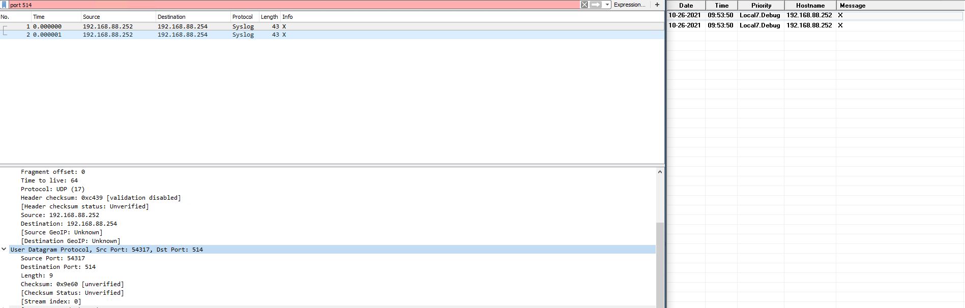

Here is the kiwi computer capture by wireshark.
Wireshark and the right and kiwi on the left.

There are no IP packet coming in from the router on port 514 but from Ubuntu there are.
