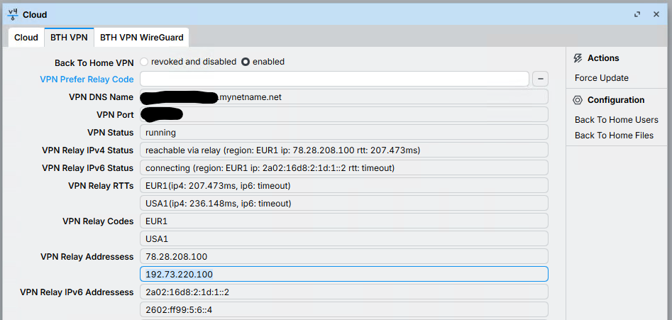

If you look at e.g. the WinBox menu for BTH, the pings for the different BTH relays are displayed, so the choice is probably made on the router itself.

I didn't understand, if this is the complete list of relays or they are an extract of the "fastest" ones that the system would like to use... In addition to the "VPN Preferred Relay Code" option, I can indicate any relay (and if there is a complete list) Or are the only 2 relays available (at the moment) these indicated on the screen?
Well... I fully expected to write that currently this seems to be the full list.
The usual way to implement this on the networking side is to have "servers" instead of servers, where each published ip has multiple physical (or virtual) machines behind it, and routing is done with some type of ECMP.
It seems to not be so with Mikrotik BTH. For me, on a different device, the same list that you posted shows the same addresses with x.y.z.98, so a different last octet.
Maybe this is derived from the S/N? DNS round-robin? Anyhow, currently the full list seems kind of hard to get...
