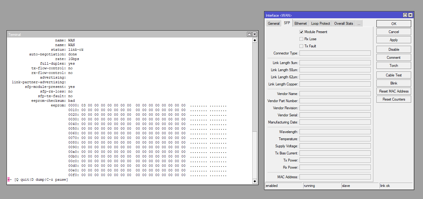

Could be very useful to include the feature to make that the Mikrotik Routers/Swithches with SFP/SFP+ ports be able to do sequential Single-Byte reads to obtain the transceiver specs and ddm from the EEPROM tables A0h/A2h for transceivers like GPON ONU SFP and others than only supports Single-Byte Reads and not multi-bytes reads (255 Bytes read per call).
Some of this transceivers doesn’t have connected the two-wire interface SFP pins directly to the EEPROM, They have connected the 2-wire interface to a slave i2c interface of the SoC and then the SoC have a master i2c connection to the EEPROM.
in other cases the transceiver doesn’t have a physically EEPROM and use a virtualized EEPROM allocated on the SPI Flash chip that comes available after the embedded OS is booted.
Implementing the detection of the EEPROM reads to switch automatically between Single-Byte and Multi-Byte reads should not so complex and will gives a plus in the interoperability between the different brands and models of SFP Transceivers apart of to make complies the SFF-8431

Both Bell and Telus in Canada provide SFP modules having the same issue.
Both MikroTik and EdgeRouter need to fix the same issue.
Whoever fixes it soon, will save thousands of media converters for small businesses.
Situation worsened with release of new router models.
We are talking about SFP-modules based on Realtek RTL8672/RTL9601C chips.
On all new router models and CCRs these modules are detected, but no RX data are transmitted. I had this happen with my new RB5009. However, on the RB760iGS these same modules work fine.

On all new router models and CCRs these modules are detected, but no RX data are transmitted. in my CCR1009-8G-1S dont work
I confirm. Apparently this is a software problem with ROS and it will not be difficult for developers to fix it.

Currently dealing with this issue as well with a Bell GPON SFP in my CCR2004.

What’s new in 7.8beta2 (2023-Jan-20 12:27):
*) sfp - fixed reading of SFP EEPROM on single SFP port devices;
