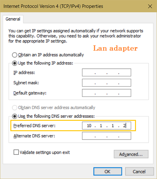

For example, all I need to do for any OS (Windows, Linux, FreeBSD) to make them resolve LAN’s host names is to configure the ip of the local DNS server in the network adapter’s properties.
When I configure Mikrotik’s LAN bridge properties I see only IP/subnet field - there’s no DNS entry as that in Windows or Linux - is there' a way just “tell” Mikrotik which local DNS server should be used for local name resolution?

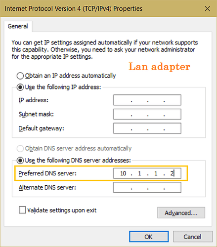

Regarding this: “Setup another server that resolve local host names... etc.” - I have already AD-based DNS servers in my LAN so where in Mikrotik can configure this server?
As far as I understand in the DNS server settings I must configure DNS servers for external queries - the ones that the Mikrotik’s caching DNS SERVER will be using. I need to configure the CLIENT settings for the Mikrotik LAN interface (mostly the bridge interface), something like this:
Suppose I don’t enable Mikrotik DNS and DHCP servers - is it possible???

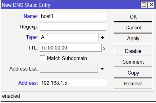

People in this thread has told you multiple times already, you set it under IP -> DNS.“ - yes, and I multiple times tried to explain that manually adding hostname\ip mappings is not what I need.
According to google adding static DNS entry should be done in the following way:
To add a static DNS entry in MikroTik, navigate to IP > DNS in WinBox, click Static, then click + to add a new Name (e.g., nas.local) and Address (e.g., 192.168.88.10). Ensure "Allow Remote Requests" is enabled in the DNS settings so clients can use the router for lookup.
Method 1: WinBox (GUI)
  1. Go to IP -> DNS.
  2. Click the Static button.
  3. Click the + (Add) button.
  4. Name: Enter the domain/hostname (e.g., mydevice.lan).
  5. Address: Enter the IP address (e.g., 192.168.88.50).
  6. Click OK.
In other words I must add all my local host names one by one while I just need to redirect queries for ALL local names to my internal DNS server. As you picture shows that can be done in the same IP-DNS window but with the different type = FWD and this was never mentioned here before. Thank you for the explanation.
